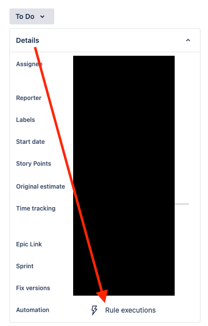

To trigger the run of a rule manually, look in the Details section of the view of an issue. At the bottom you should see an "Automations" field.
Click on that.
You should then get a pull down list of rules that can be manually triggered.
I have found that secondary screen where the pull down is displayed is unreliable. Sometimes the pull down doesn't work. Sometimes it says there are no rules available.
