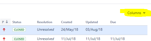

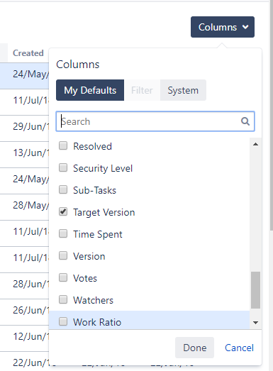

This is how we used to add columns  on the old JIRA version,
Fisrt step : column1.PNGSecond Step:
