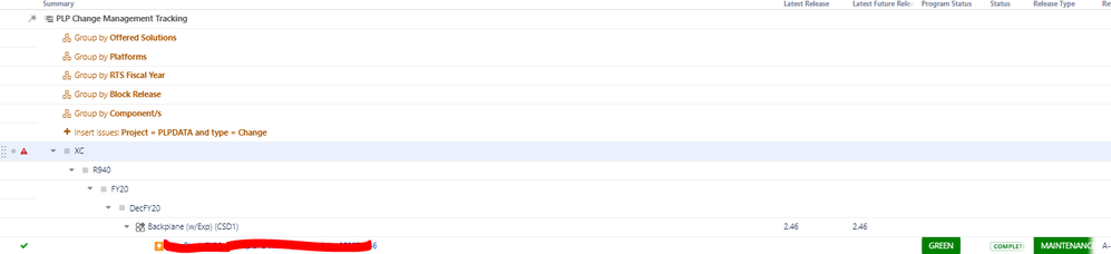

Currently, we are using Structure add-on to Group custom fields value on 5 levels. Everything is working fine but we are facing performance issues while loading the Structure pages and Automation on Strcutre page is pausing when users are updating the issues in Project.
To limit the custom field values in Grouped by custom fields and we have inserted original structure and by using S-JQL query filtered Values from Level1 and Level2 Grouped by custom field values, it is working fine again but when users updating issues in the project automation is getting paused and even tried increasing automation time in structures still same issues. Please see the sample structure below.
Let me know if there is any add-ons with similar functionality.
