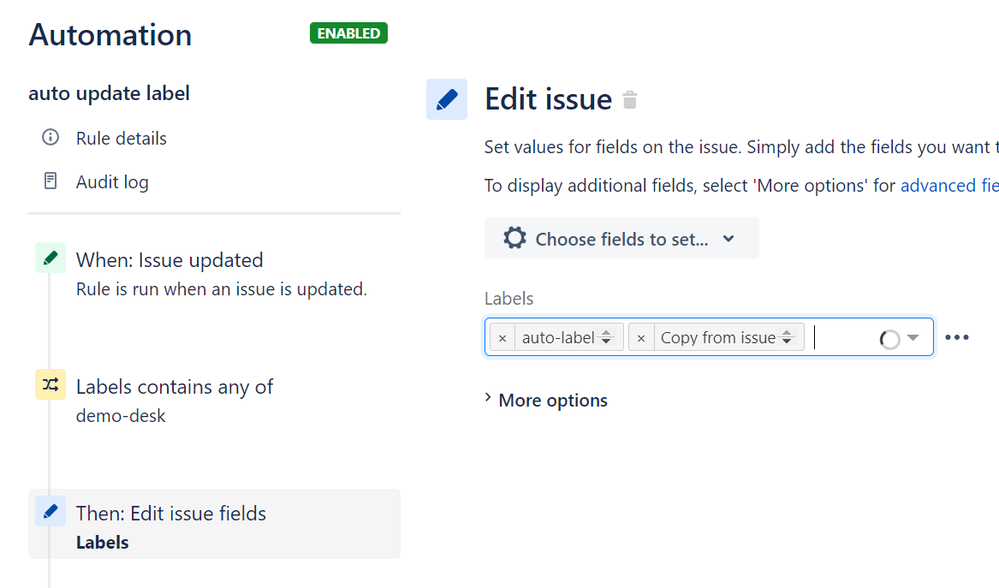

An automation like this helps?
Actually this will delete the old labels it may have and just sets the new label, I need to append the label.
ah.. i get that..
update it like below with 'Copy from issue'
