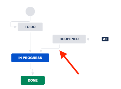

Here is a simple example workflow diagram.

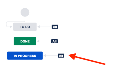

When you see a Global transition like the one pointed to by the red arrow that means an issue in ANY valid workflow status can be changed to the status pointed to by All.
From Status >> To Status
All (Any) >> In Progress
The Global transition indicates which statuses the issue can be in currently and then be changed to the destination status pointed at by the transition.
If you have a Reopen status in your workflow and Global transitions to other statuses in your workflow, then an issue in the Reopen status can be transitions to any status pointed to by a Global transition. In the workflow above, if I added a Reopen status, issues in the Reopen status could be transitioned to To Do, In Progress, or Done.

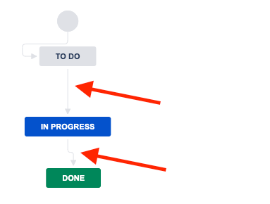

Here is another example workflow. In this case there are no Global transitions.
In this case the transitions indicate limited options:
To Do >> In Progress
In Progress >> Done

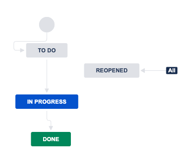

If I added a Reopen status to this workflow with a Global transition to it, that would allow issues in any status to change to Reopen, but not allow an issue that is currently in Reopen to change to anything else.

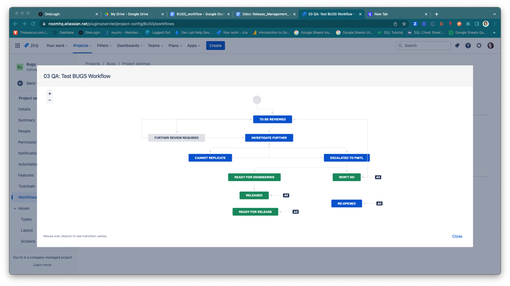

@Trudy Claspill thanks for your thorough reply! Here is my workflow where I would like for a reopened issue to transition back to an in progress statusScreenshot 2023-04-20 at 8.29.29 AM.png

I bring this up because I see that your RE-OPENED status is blue, so technically it is part of the "In Progress" Status Category. I'm not sure if that is what you intended.
I also notice that your issues go directly to a Blue status when they are created. Typically issues go to a Gray (To Do) type of status when they are created to indicate no work has been started yet.
Now, looking at your workflow diagram, I see that for all your other Blue statuses none of them have a Global transition ( the ALL --> transition pointing to them). In order for your issues to go from the RE-OPENED status directly to any of those other Blue statuses you are going to have to create transitions from RE-OPENED to each of those other statuses.
The statuses RELEASED, READY FOR RELEASE, and WON'T DO all have Global transitions, so an issue can go from RE-OPENED to any of those three statuses, unless there is a Condition or Validator on the transitions that would prevent that.
