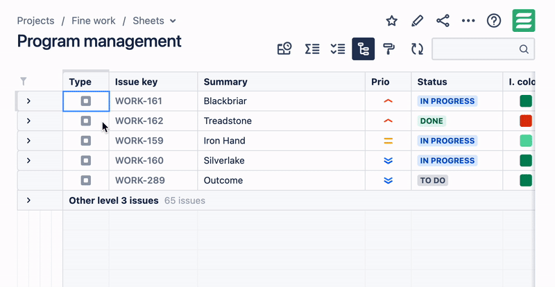

As suggested, you can set this up using multiple projects. Just as food for thought, another way to implement the exact hierarchy you are looking for is via work item linking. Work item links give you full flexibility in how you can model your hierarchy, even in team-managed projects, plus unlike Jira hierarchy configuration, they don't globally impact your whole site.
The downside is that work item links aren't natively recognised as parent/child relationships, so you won't get a lot of hierarchy-related features out of the box. This being said, if you are open to solutions from the Atlassian Marketplace, there's a number of apps available that you can use to configure customised work item hierarchies.
E.g., this is how your hierarchy could look in the app that my team and I are working on, JXL for Jira:
In this example, I have implemented a bespoke hierarchy of work types in a team-managed project: Programs, Initiatives, Epics, Stories/Tasks, Subtasks. Work items on the higher levels are connected to each other via "is parent of" / "is child of" work item links, and the work is visualised in a custom structure.
