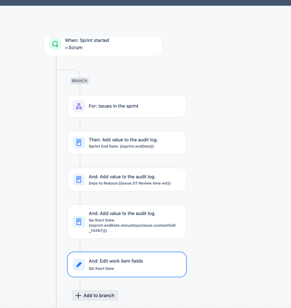

So build to following automation, from global automation:
Trigger: Sprints Starts
Branch on: For Each: issues in the sprint
Edit work-item:
field = Qa Start Date
Value = {{sprint.endDate.minusDays(issue.customfield_10287)}}
** Replace the "10287" with your custom field number.

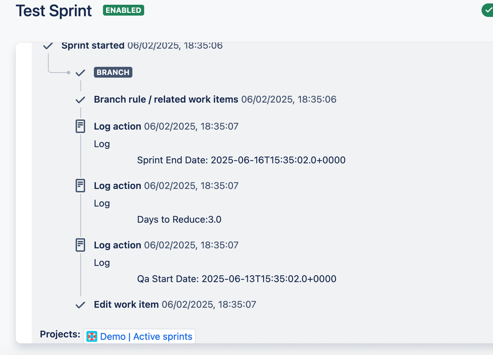

you can also add logs if you want to view the runs.

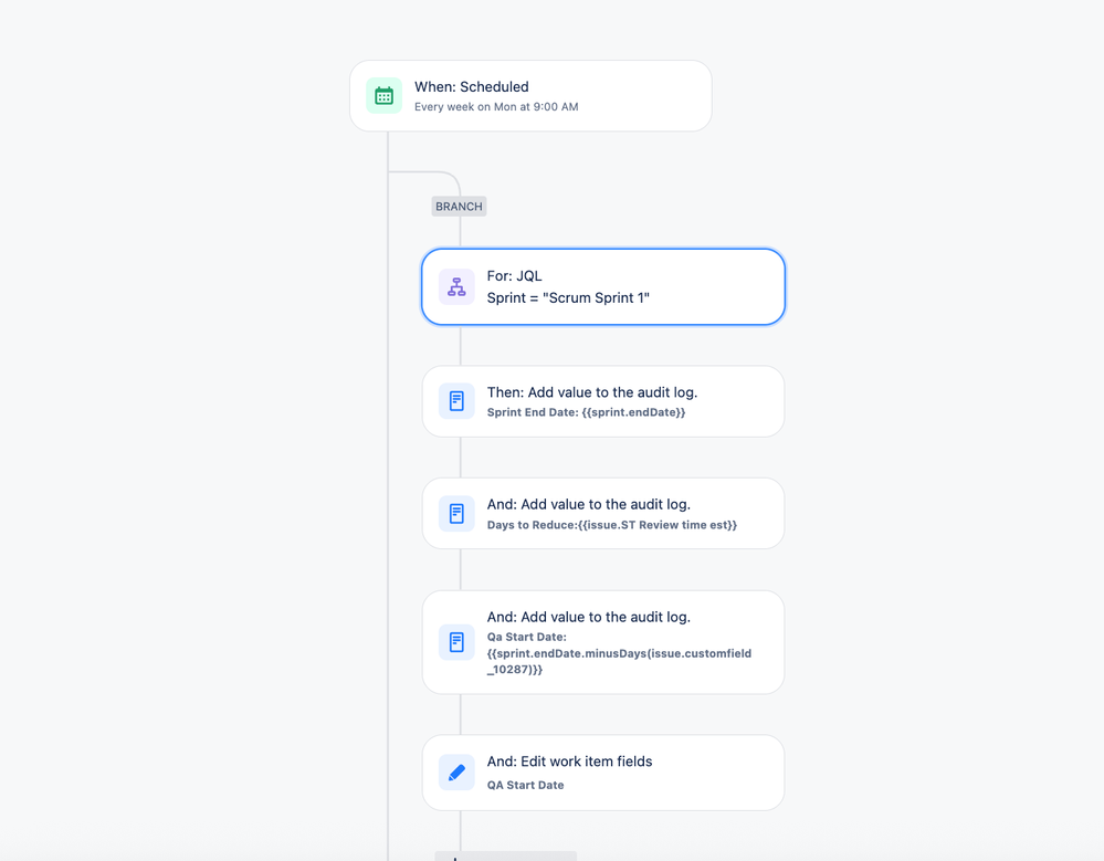

First, Copy the automation you have made.
Replace the trigger to "Scheduled" (do-not set any JQL in it!)
New branch : based on JQL: Sprint = "Sprint Name"
and keep all actions as in the original automation.
after run - disable it so it wont run on the schedule date :-)
