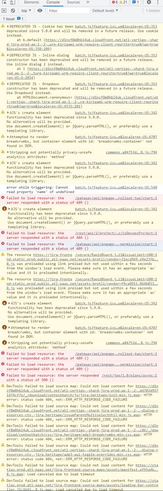

Please, open the developer tools on your browser and check on the console tab if it shows any error. If so, please, share with us.

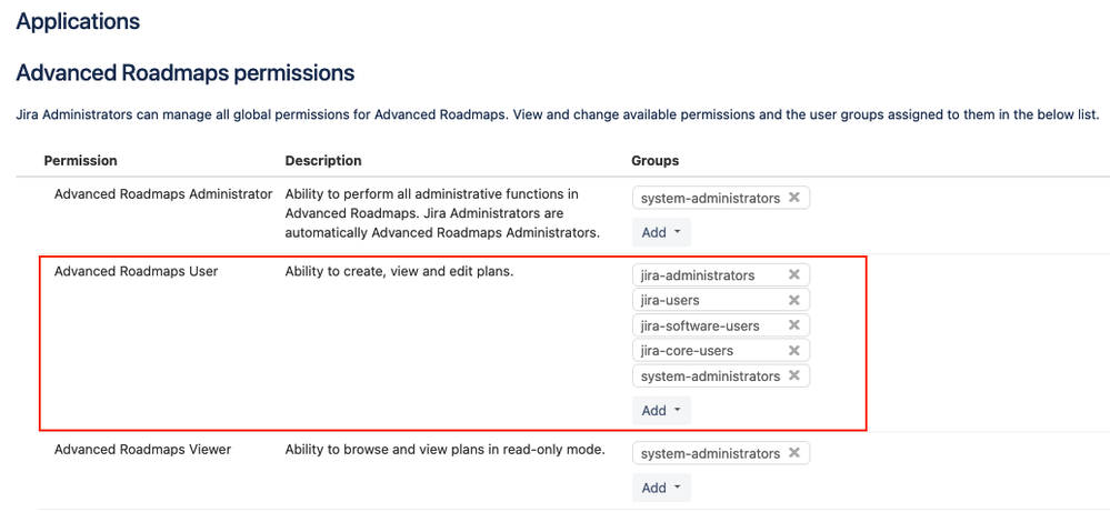

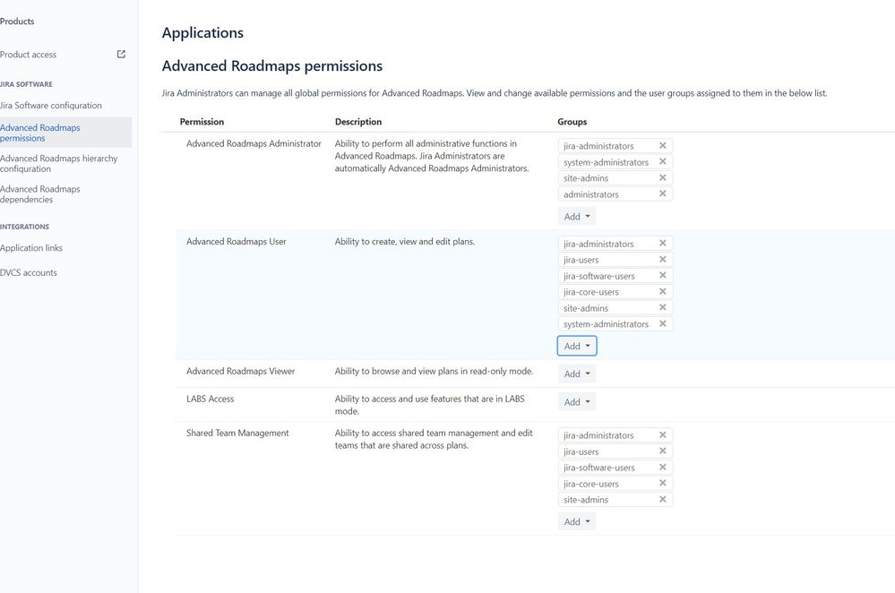

Also, if you have administrator access, go to Plans > Settings and confirm if the groups you are part of have the “Advanced Roadmaps User” permission. If you don’t see the Settings option, please, reach out to your administrator for them to check this information.

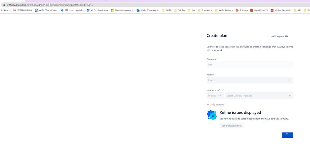

Hi Angelica @Angélica Luz
I am having the same problem. I have tried another browsers and checked I have permissions
I have attached screen images and the console messages from the browser
Any thoughts :-)
Cheers Warde

"batch.js?feature-issue-details-fix-css-override-for-ak-renderer=true&feature-kirigami-safer-load-bridge-api=true&feature-kirigami-wrm-require-client-rewrite=true&jag=true&locale=en-US:353 DEPRECATED JS - Cookie has been deprecated since 5.8.0 and will be removed in a future release. Use cookie instead.
at b.default (https://d1nzf8m8hbl4uk.cloudfront.net/atl-vertigo--shard-jira-prod-ap-1--2--jres.atlassian.net/s/d41d8cd98f00b204e9800998ecf8427e-CDN/r5gghz/b/3/c4b958ac527aeeadd703d9571474cf7e/_/download/contextbatch/js/jira.heritage/batch.js?feature-issue-details-fix-css-override-for-ak-renderer=true&feature-kirigami-safer-load-bridge-api=true&feature-kirigami-wrm-require-client-rewrite=true&jag=true&locale=en-US:350:209)
k @ batch.js?feature-issue-details-fix-css-override-for-ak-renderer=true&feature-kirigami-safer-load-bridge-api=true&feature-kirigami-wrm-require-client-rewrite=true&jag=true&locale=en-US:353
batch.js?feature-issue-details-fix-css-override-for-ak-renderer=true&feature-kirigami-safer-load-bridge-api=true&feature-kirigami-wrm-require-client-rewrite=true&jag=true&locale=en-US:353 DEPRECATED JS - Inline dialog constructor has been deprecated and will be removed in a future release. Use inline dialog 2 instead.
at l (https://d1nzf8m8hbl4uk.cloudfront.net/atl-vertigo--shard-jira-prod-ap-1--2--jres.atlassian.net/s/d41d8cd98f00b204e9800998ecf8427e-CDN/r5gghz/b/3/c4b958ac527aeeadd703d9571474cf7e/_/download/contextbatch/js/jira.heritage/batch.js?feature-issue-details-fix-css-override-for-ak-renderer=true&feature-kirigami-safer-load-bridge-api=true&feature-kirigami-wrm-require-client-rewrite=true&jag=true&locale=en-US:6:2054)
batch.js?feature-issue-details-fix-css-override-for-ak-renderer=true&feature-kirigami-safer-load-bridge-api=true&feature-kirigami-wrm-require-client-rewrite=true&jag=true&locale=en-US:353 DEPRECATED JS - Dropdown constructor has been deprecated and will be removed in a future release. Use Dropdown2 instead.
at HTMLDocument.<anonymous> (https://d1nzf8m8hbl4uk.cloudfront.net/atl-vertigo--shard-jira-prod-ap-1--2--jres.atlassian.net/s/d41d8cd98f00b204e9800998ecf8427e-CDN/r5gghz/b/3/c4b958ac527aeeadd703d9571474cf7e/_/download/contextbatch/js/jira.heritage/batch.js?feature-issue-details-fix-css-override-for-ak-renderer=true&feature-kirigami-safer-load-bridge-api=true&feature-kirigami-wrm-require-client-rewrite=true&jag=true&locale=en-US:4535:201)
batch.js?feature-issue-details-fix-css-override-for-ak-renderer=true&feature-kirigami-safer-load-bridge-api=true&feature-kirigami-wrm-require-client-rewrite=true&jag=true&locale=en-US:342 AJS's create element functionality has been deprecated since 5.9.0.
No alternative will be provided.
Use document.createElement() or jQuery.parseHTML(), or preferably use a templating library.
a.default @ batch.js?feature-issue-details-fix-css-override-for-ak-renderer=true&feature-kirigami-safer-load-bridge-api=true&feature-kirigami-wrm-require-client-rewrite=true&jag=true&locale=en-US:342
batch.js?feature-issue-details-fix-css-override-for-ak-renderer=true&feature-kirigami-safer-load-bridge-api=true&feature-kirigami-wrm-require-client-rewrite=true&jag=true&locale=en-US:4707 Attempted to render breadcrumbs, but container element with id: 'breadcrumbs-container' not found in DOM.
a @ batch.js?feature-issue-details-fix-css-override-for-ak-renderer=true&feature-kirigami-safer-load-bridge-api=true&feature-kirigami-wrm-require-client-rewrite=true&jag=true&locale=en-US:4707
commons.a84753df0dda1db5dbc5.8.js:sourcemap:794 Stripping out potentially privacy-unsafe analytics attribute: 'method'
(anonymous) @ commons.a84753df0dda1db5dbc5.8.js:sourcemap:794
batch.js?feature-issue-details-fix-css-override-for-ak-renderer=true&feature-kirigami-safer-load-bridge-api=true&feature-kirigami-wrm-require-client-rewrite=true&jag=true&locale=en-US:540 error while triggering: Cannot read property 'name' of undefined
2batch.js?feature-issue-details-fix-css-override-for-ak-renderer=true&feature-kirigami-safer-load-bridge-api=true&feature-kirigami-wrm-require-client-rewrite=true&jag=true&locale=en-US:342 AJS's create element functionality has been deprecated since 5.9.0.
/gateway/api/engage-targeting/api/v2/user/18b673f2-c17d-4139-8ac5-486b8e3292d4/messages/issue-details-admin-options-rollout-two/start:1 Failed to load resource: the server responded with a status of 409 ()
/rest/api/2/project/SCPI/properties/isDevopsProject:1 Failed to load resource: the server responded with a status of 404 ()
/gateway/api/engage-targeting/api/v2/user/18b673f2-c17d-4139-8ac5-486b8e3292d4/messages/jira-insights-onboarding-tour-permission/start:1 Failed to load resource: the server responded with a status of 409 ()
/rest/jpo/1.0/plans/async:1 Failed to load resource: the server responded with a status of 500 ()
DevTools failed to load source map: Could not load content for https://d1nzf8m8hbl4uk.cloudfront.net/atl-vertigo--shard-jira-prod-ap-1--2--jres.atlassian.net/s/d41d8cd98f00b204e9800998ecf8427e-CDN/r5gghz/b/3/c4b958ac527aeeadd703d9571474cf7e/_/download/contextbatch/js/jira.heritage/init-min.js.map: HTTP error: status code 404, net::ERR_HTTP_RESPONSE_CODE_FAILURE
DevTools failed to load source map: Could not load content for https://d1nzf8m8hbl4uk.cloudfront.net/atl-vertigo--shard-jira-prod-ap-1--2--jres.atlassian.net/s/d41d8cd98f00b204e9800998ecf8427e-CDN/r5gghz/b/3/d3fb8c25074b1000f369c8ad9af5c5eb/_/download/contextbatch/js/greenhopper-rapid-non-gadget-backlog,gh-rapid-backlog,jira.global,atl.general,jira.general,atl.global,com.pyxis.greenhopper.jira:rapid-board-plan-page,gh-rapid-config-backlog,jira.webresources:mentions-feature,com.atlassian.jira.plugins.jira-development-integration-plugin:devstatus-dialog-resou...: HTTP error: status code 404, net::ERR_HTTP_RESPONSE_CODE_FAILURE
DevTools failed to load source map: Could not load content for https://d1nzf8m8hbl4uk.cloudfront.net/atl-vertigo--shard-jira-prod-ap-1--2--jres.atlassian.net/s/d41d8cd98f00b204e9800998ecf8427e-CDN/r5gghz/b/3/252b159b01cc775d640b0eaa8dd22c86/_/download/contextbatch/css/jira.heritage/adg3-breadcrumbs-min.css.map: HTTP error: status code 404, net::ERR_HTTP_RESPONSE_CODE_FAILURE
DevTools failed to load source map: Could not load content for https://d1nzf8m8hbl4uk.cloudfront.net/atl-vertigo--shard-jira-prod-ap-1--2--jres.atlassian.net/s/d41d8cd98f00b204e9800998ecf8427e-CDN/r5gghz/b/3/025d38d64e0fa6b27dcf372650b1e8ad/_/download/contextbatch/css/greenhopper-rapid-non-gadget-backlog,gh-rapid-backlog,jira.global,atl.general,jira.general,atl.global,com.pyxis.greenhopper.jira:rapid-board-plan-page,gh-rapid-config-backlog,jira.webresources:mentions-feature,com.atlassian.jira.plugins.jira-development-integration-plugin:devstatus-dialog-reso...: HTTP error: status code 404, net::ERR_HTTP_RESPONSE_CODE_FAILURE"
