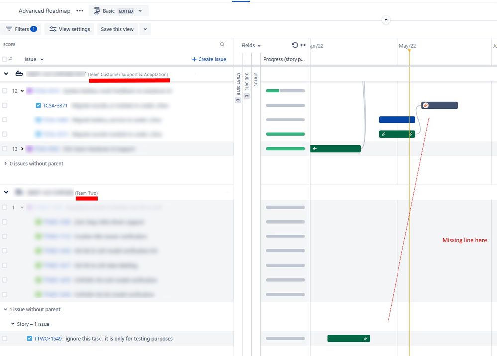

If I have the "line" option selected to show the dependencies, when I add depencency between two tasks within a team , we can see the lines from one to another. Also all good here.
However, when I try to add a depencency between two different teams/projects, the lines do not show. The dependency is created, because if I go to the source task, I can see that it is blocking the other one, but no line is visible, which somehow blows one of the nice features of the advanced roadmaps, which is outlining the external dependencies in a very visual way.

I have same issue. It definitely that you only see lines when between issues in same project. Across project only shows the symbol not the line.
It would be advantageous to see lines across projects otherwise we have to now use another product to present the programme of projects.
by trying for several hours i found out that depending on the Filter settings, the lines are showed or not. Specifically the "Group by" field sees to make a bog difference. But still, when you group issues by Project/team, the lines are not shown, which clearly hinders one of the nicest features of AR, which is easily tracking dependencies between teams
I have the same issue too. The dependency lines between tickets from different projects show up when `Group by` is set to `None`. As soon as I set `Group by` to `Project` or `Team`, which is a more useful view, they are gone.
Visualizing dependencies across projects is the main reason why our teams want to use advanced roadmap... plus in the screenshots on the advanced roadmap feature page, it does appear that dependency lines across teams should show up.
I encountered the same problem and may have found a workaround (which is obviously not perfect).
If you remove the Group by team setting and then add the column "Team" (-> "fields") you can then sort the roadmap by team. It is not perfect, but at least you have a chance to identify the cross-team dependencies.

the settings seem to be correct (actually some of the lines do show up)
so, in the screencap below, tasks 1549 and 3371 do have a depencency link, but the line is now showing and as you can see some of the other depencencies (the ones within the team) do show up
