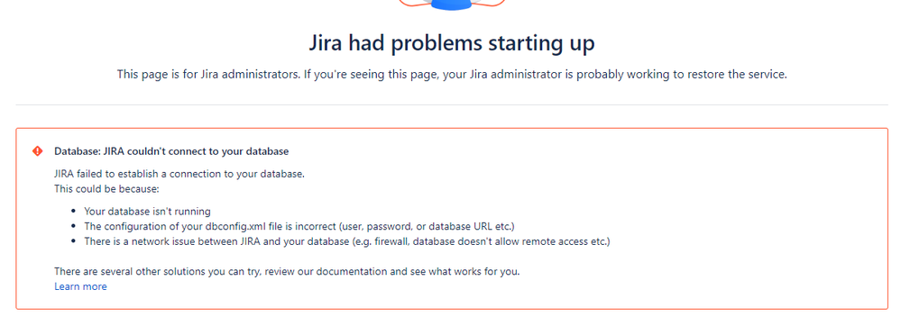

Error:
If I write extra https://mycompany.bla:8443 or https:// IP-Address:8443
the error is the same with database as above.

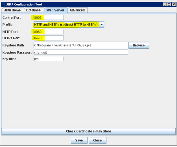

I took the same values for my jira certificate.  as under in picture
Maybe this picture is helpful for you

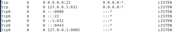

I don't use appache. I used IP-Tables, but for now I deleted it.
Has anyone an Idea?

Thank you for response,
But I receive the same Error with the Database.

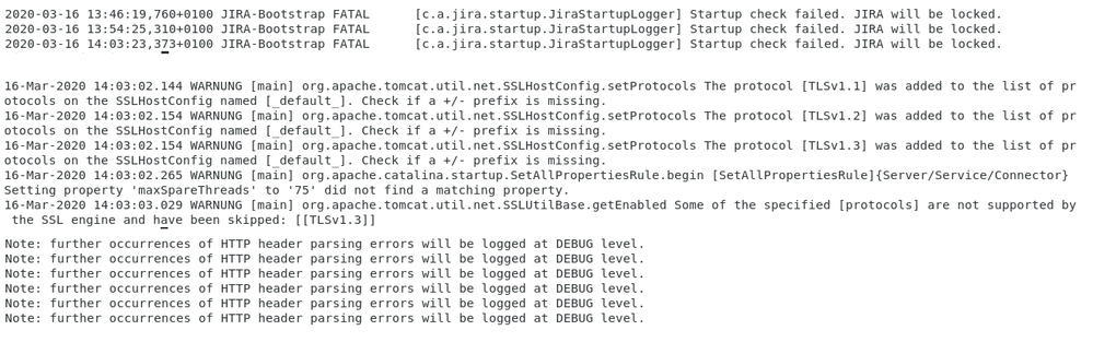

In my catalina.out file are following errors.
