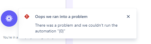

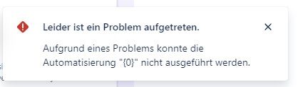

The only clue I have, is when I do a manual action for a automation. Then I get a small popup message, which tells me something like: "The automation "{0}" has an error". But it does not tell me what the error is or what the "{0}" actually means. :(

There is not much i can share, only the pop up. The automation-use-log is empty
Michael simon September 7, 2024

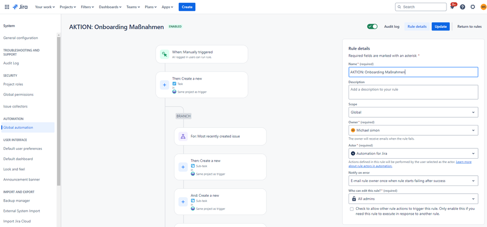

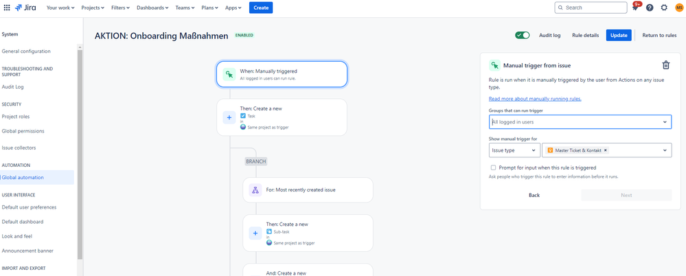

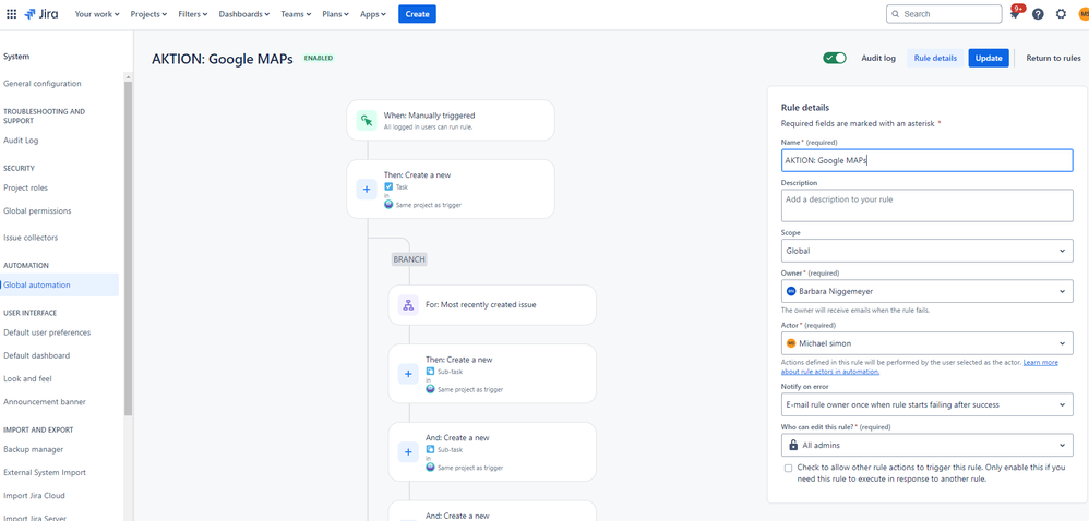

Can you share the actual rule? Showing the rule details page.
Michael simon September 8, 2024
Since every automation on every project is not working, I am not sure if you will see something. But I will make screenshots for you for the trigger, since the trigger doesn't seem to work. Otherwise I probably would of seen some kind of usage log file.
Here are the images of two different triggersScreenshot 2024-09-08 201129.pngScreenshot 2024-09-08 201045.pngScreenshot 2024-09-08 201028.pngScreenshot 2024-09-08 201011.pngScreenshot 2024-09-08 200936.png:
