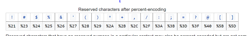

  1. Jira is Url-encoding special characters in the Webhook url when sending the request and this is causing the integration to fail
  2. When using short urls, some parts of the body and header are missing
Now, if my understanding is correct:
  1. This is expected behavior: as written in RFC-3986 Uniform Resource Identifier (URI): Generic Syntax reserved characters needs to be percent-encoded (or url-encoded)

Hi @Dario B  Thanks for the response, percent-encoded (or url-encoded  doc helped me to find my solution. I have replaced reserved character of the the Azure URL with related one  provided on wiki and it started working. Thank you so much for your assistance.
