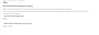

They each need a different field configuration. However when we try to change the FC scheme , it allows me to change Bug to the Bug field config:
However, when I try to change the task issue, it moves the bug issue type back to default:

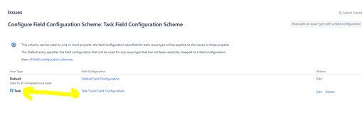

Project uses the same FC scheme for the 3 issue types:
when I try to associate a issue type I am only allowed to change one the other 2 remain in default. Change scheme for bug to bug fc scheme as you select a scheme then it is assigned to the issue ( I believe this is where the issue is?)
Shows Bug Issue with correct bug FC: other 2 issues types are still in default:
If I attempt to change another it removes the prior one I change and sets it back to default change task to task FC: MOVES BUG back to default???

...what you did was create 3 Field Configuration Schemes; one for each type of issue. What you need to do is create ONE Field Configuration Scheme, and in it add each type of issue with its associated Field Configuration. You must also have a default Field Configuration defined in the Field Configuration Scheme. The default Field Configuration will be used for any issue type that is not otherwise explicitly called out in the Scheme to be associated with a particular Field Configuration.
Here's an example of a Field Configuration Scheme that serves different Field Configurations depending on the type of issue.
The Story issue type uses the "DEV: STORY Default Field Configuration" field configuration.
Any other issue type available in the project will use the "DEV: Default Field Configuration" field configuration.
To add more issue types and associate each one with a particular Field Configuration, click on the button in the upper right labeled "Associate an issue type with a field configuration". That will pop open a dialog where you select the issue type (i.e. Bug) and the Field Configuration to associate with that issue type.
Here I've added the Bug issue type
Once you have all the issue types you want and their associated field configuration, plus a Default field configuration, in your Field Configuration Scheme, then you go to your Project Settings, select Fields, and use the Action button to access the Use A Different Scheme option.
Through that you select the new Field Configuration Scheme you created.
