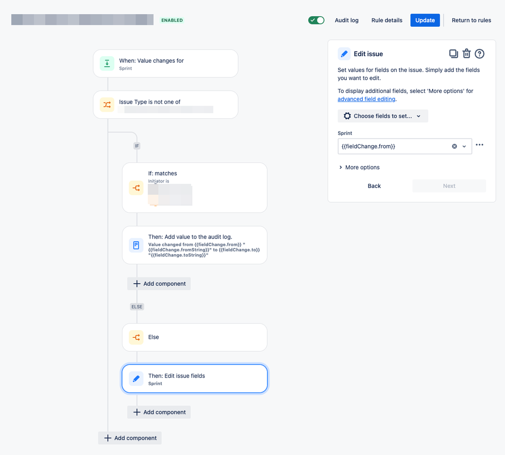

Hence, I set up an automation as below:
Monosnap Audit log - Automation - Ninox development - Jira 2024-03-25 14-47-59.png

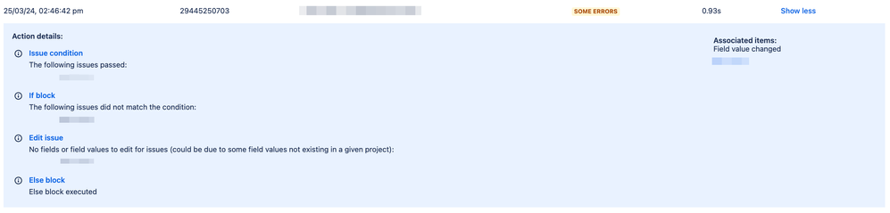

However, I keep getting the below error
Monosnap Audit log - Automation - Ninox development - Jira 2024-03-25 14-56-46.png

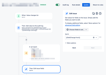

The way you have the rule written, if the Initiator of the rule (the person who edited the Sprint field) matches to a list then you are only logging information into the rule's audit log. Otherwise, the Initiator doesn't match your list and you are editing the issue to change the Sprint field.
My first suggestion is that you put the Log action before the step checking the Initiator. That way you get the data into the log regardless of whether or not you will try to edit it later.
Second, you don't need an If-Else. You could use just an IF and say "if Initiator does not match" the list of users that are allowed to change the Sprint field.
Third, in order to edit the Sprint field in a rule the Sprint field needs to be on the Edit Screen/Layout for that type of issue, and the Actor of the rule must have sufficient permissions to edit the field.
Lastly, the Sprint field is a multi-value field. I don't think it is going to be as simple as trying to reset the field to the "from" value before it was changed. But we'll know more about that after you move the Log action so that the information is always being printed with each run of the rule.

Yes, I made both the above changes (screenshot below).
Monosnap Rule builder - Automation - Ninox development - Jira 2024-03-25 17-38-55.png
