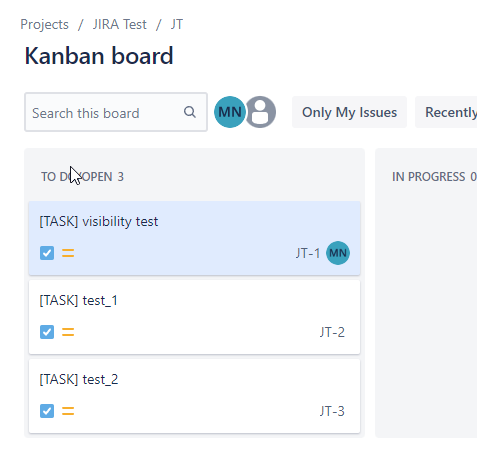

2- I created another group called "Project involved users". I assigned "Browse Projects" permissions to this group and kept the Issue Security Schemes as before. In this case the user in this group can see all the issues in the project and not just the ones assigned to him. Which I do not want.
In the picture below the MN user is assigned to the [Task] visibility test but as you can see he can also see tasks that are not assigned to him.

Matteo Napoleoni July 21, 2023
Thank you very much!
It works but I would like to make a note that might be useful for other users.
The reason why it didn't seem to work to me is that the old issues in the project don't automatically get the new security level set.
This is confirmed by the image below:
The permissions can be changed by doing a "Bulk change" --> Edit Issues --> Change Security Level and in the drop-down menu choose the desired Issue Security Schemes
