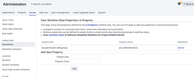

That said, you could give the reporter permissions on a project level to edit their own issue, and then later you can restrict them from making changes to the issue when it exists in different statuses. This can be done with Workflow Properties. Specifically, I was able to do this by going into the workflow in question, edit that workflow, click on the status in question, and select Properties. From here you can add a property such as
jira.permission.edit.group = jira-administrators
(that format would look like this in the workflow properties page:)
Adding this property, and then publishing the workflow would prevent any user that was not in that specific group from editing the issue when it was in that specific status of that workflow; even if they actually do have the permissions to do that in the project.
I tried to do this by using the reporter role instead of a specific group name, but it did not seem to work for me. At least in this way of restricting by group, the reporter could edit the issue at least until the issue is first transitioned. You would need to add this property to the other statuses in the workflow (except for the first status after the issue is created). Also if your workflow permits the user to transition the issue back to that initial state, they could get past this limitation by doing that first.
