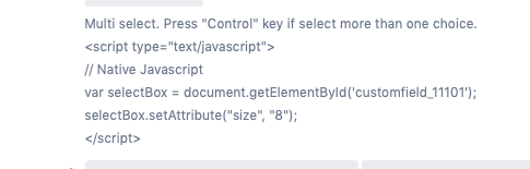

Hi Lasse,
Thank you so much for the suggestion. Where should I put this script in? If I put it in the field configuration custom field description area, It seems Jira v8.7 removed the ability to run script there. Should I put it in banner? If so, the script will apply to all projects (not project, issuetype specific anymore). Here is what I got in the field description when I create a ticket:
Thanks again,
Sara
Hi @Sara Lam
I would the place the HTML in the Jira banner and yes it will be executed for all Jira projects.
If this is not OK then I will take a look at Behaviours from Scriptrunner which is capable of controlling Jira issue field behaviour.
