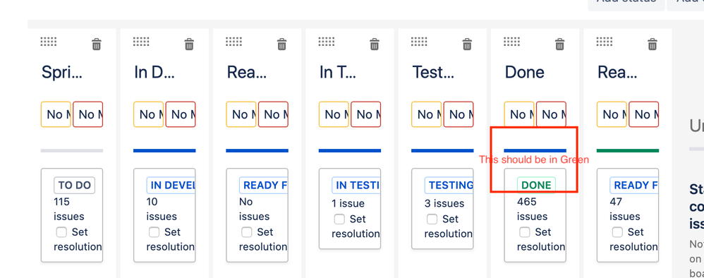

Added all the required status, but am not able to see "Done" consider as burndown chart as attached in my previous screenshot
This is my problem. i hope if we change to Green and associated with status to done, then our problem got resolved.

There are no screenshots here - can you update to add?
John Funk
May 6, 2020
Ah, I see now. Done has to be the last column on a Scrum board.

Now burndown chat also not mapped with Done status it is taking from "Ready for Staging". Could you please help me to resolve this issue.

You need to move the Done column to the last column of the board.
If it is done then you don’t keep working on it.
If there still work to do on it and it finishes that stage, you can’t mark it doing. If you want it to be done then you should create a new card with the rest of the work.
