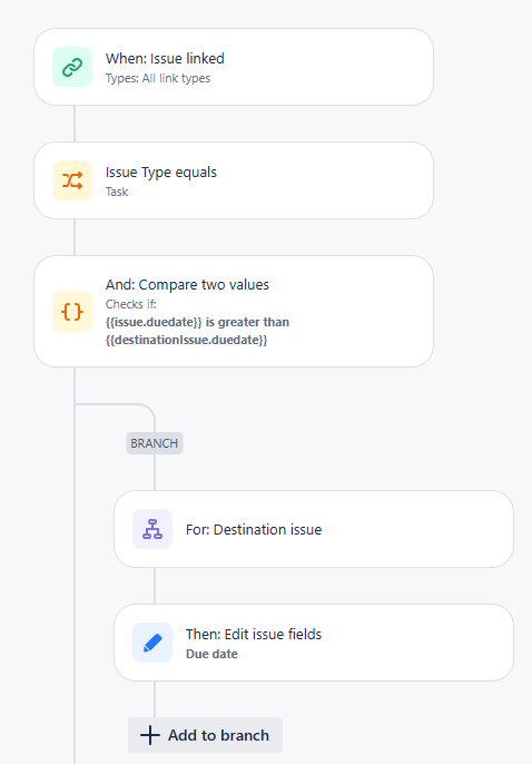

If I understood your question right, this can be achieved by simple comparing of dates.
When new issue is linked, you are just checking, that in linked issue due date is smaller, and updates it. Made basic example, for describing of my logic:

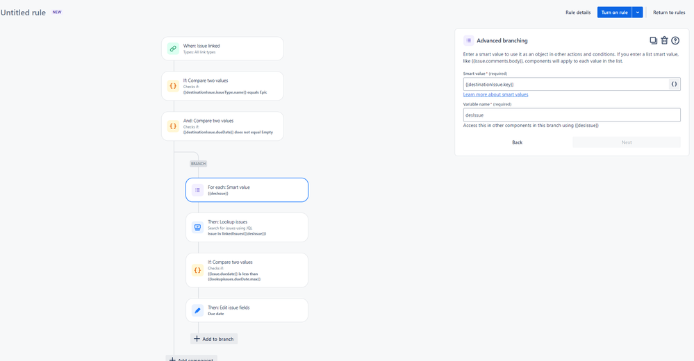

I did some more digging around today and am trying to start it much simpler to be able to build on later as Ive seen that there is some date transformation that needs to be done between Jira Software and Product Discovery projects and some different syntax for referencing delivery items in a Product Discovery project (which ill build up to eventually)
Instead I am just starting out with attempting to update an epic due date to the max date (or keep the date thats already on the epic if it is the max) when a new link is created.
I discovered the difference between [issue in linkedIssues()] which returns relationships like "relates to" and "blocked by" vs [linkedIssue in ()] which returns children and childrens children of the issue as well as the issue itself used in the function.
Hoping Im on the right track any help would be great.
You are getting closer, although there is no need to iterate over the issues with a branch to find / compare dates. That is where the Lookup Issues action helps.
