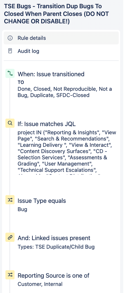

Because the automation rule starts at the top with the trigger which you cannot filter as far as I'm aware -- my trigger is when an issue transitions to particular statuses.   The problem is:   I only care about issues in certain projects and not across all of Jira.  The trigger unfortunately looks at every project and every issue transitioning to my specified statuses.   We have a LOT of projects and issues which means this automation rule runs all the time.
I have worked with Atlassian Support several times to figure out how to optimize this rule.   It focuses on issues linked from a single project to another 13.
RULE
In a nutshell the rule is looking at:

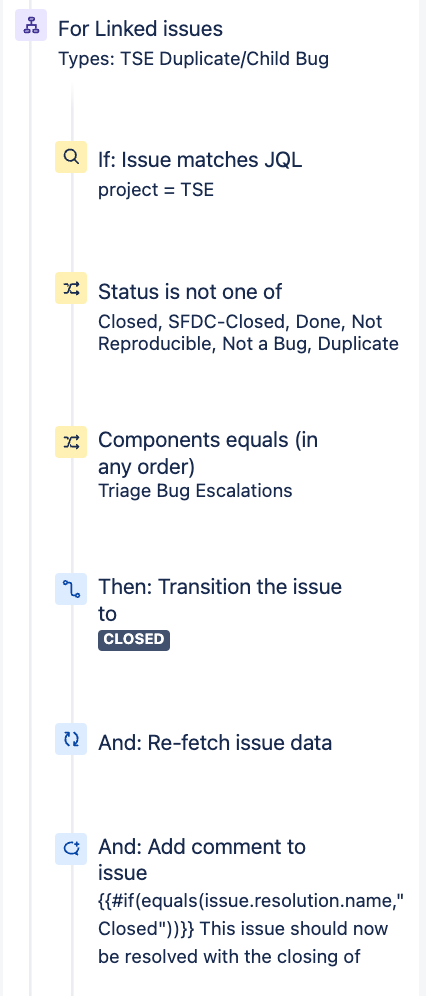

  • bug issues in Project A that are linked using a specific link type across another 13 projects.   These are considered our parent/source/original issue.
  • When these issues are found, we close Project A's child/duplicate issue
  • We update Project A's resolution value to match the parent issue's resolution value
  • We make custom comments based on the resolution value

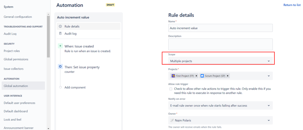

Hi @Gail
If you are the Jira admin you can create global automation and select the scope for multiple projects as necessary without having it run through all projects.
