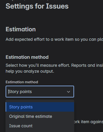

Can you confirm that your board is referencing a Company Managed project? Get the project Type information from the View All Projects page under the Projects menu.
The native "Story point estimate" field cannot be used here. That field applies to only Team Managed Software projects.
You can, however, add a custom Number field to your issues in the target project, and record your story point estimates in that field. Then that field should be selectable in the Estimation Method options.

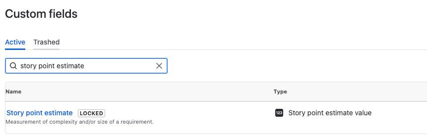

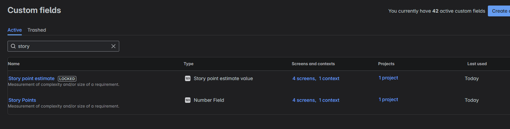

I believe I do have the Number field in the issues of this project:
I wonder if Story Point Estimate was the default with the project? and someone in the team (before me) added the Story Point field?
For example - I don't know why Story Point Estimate is a type 'Story point estimate value' instead of a Number. If it has to be a Number, that is why it's not being shown as an option in the Estimation method drop down box?

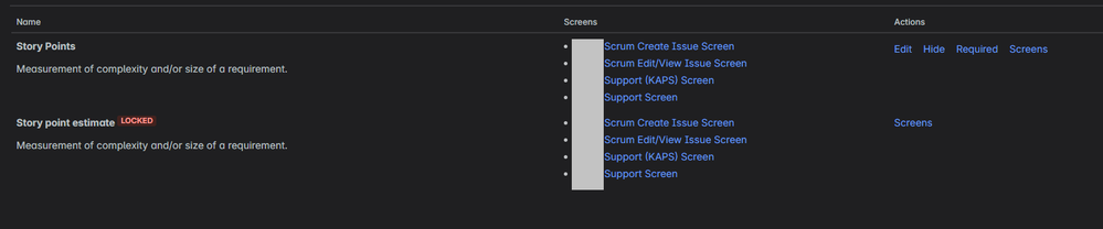

The Story point estimate field you are seeing there is the native one that is applicable only to Team Managed projects. The field type for that field is not Number.
Since it is not a Number type field, and is really intended to be used only in Team Managed projects, it will not be available in the Estimation Method options for the board even if the field is added to the Company Managed project's issues.
Story point estimate would not have been the default for a Company Managed project, since by default it is added only to Team Managed projects when they are created. Story Points is the native story point field for Company Managed projects.
As to why Atlassian created this different Story point field just for Team Managed projects and made it a different field type than Number, I have no explanation.

So, if you really want to pursue having two "points" fields to track estimates vs. actuals, you will need to create a separate Number type of custom field for your estimates, and add that field to your Company Managed project issues. You will not be able to use the native Story point estimate field as the Estimation Method.

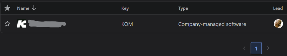

To confirm that you have correctly identified the project:
1. Look at an issue where you see the Story point estimate field displayed. Make note of the Issue Key; the AAA-123 identifier for the issue. The part on the left side of the dash is the Project Key.
2. Go to the View All Projects page under the Projects menu.
3. Find your project in that list. Make sure the Project Key from the issue in step1 matches the key of the project in the list
4. Report the text that appears in the Type column for that project, or provide a screen image of the entry.
Justin April 27, 2025
Yep, it's CM'd.

Then it is probably that another Jira Admin at some point added the Story point estimate field to the issues without fully understanding the ramifications.
