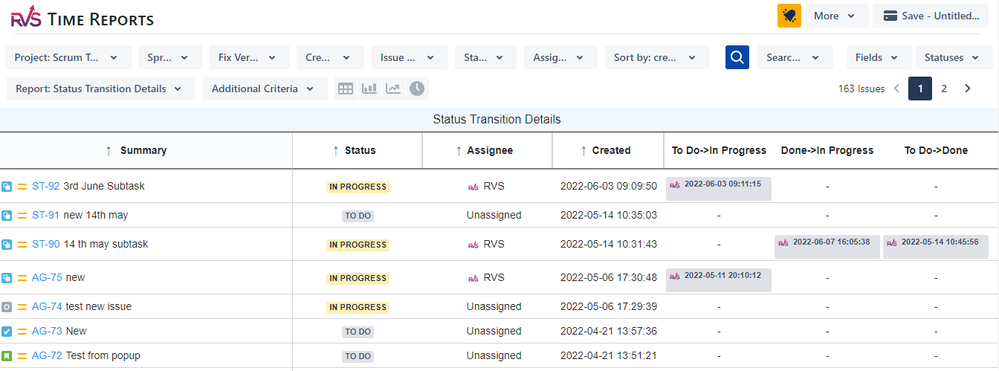

Rahul_RVS
May 5, 2025
Hi @Claire Abt
Welcome to the community !!
If you would be interested in a mktplace app for this requirement, you can try out
Time in Status Reports
For your specific need the Status Transition details report can help. It shows the transitions the issue went through and on which date as well.
With this app you generate time in each workflow status for multiple issues with multiple filter and grouping options. The app has 20+ reports to meet a variety of use cases.
More details here.
Disclaimer : I am part of the app team for this add-on

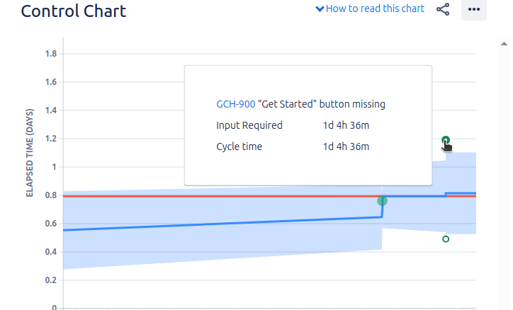

Sanam Malleswari
May 5, 2025
Hi @Claire Abt
Welcome to the Atlassian community!
Please try below options.
  • Control Chart (Reports > Control Chart) – If you're using a Jira Software board, this shows how long issues spend in each status. It’s great for spotting delays, especially if items get stuck in “Input Required”.
    View and understand the control chart | Jira Cloud | Atlassian Support
  • Marketplace Apps – Tools like "Time in Status by OBSS" or "Status Time Reports" let you see:
    • How long an issue stayed in each status
    • How many times it transitioned in/out
    • Visual reports and exports (CSV, Excel)
Claire Abt May 5, 2025
thanks -- yeah, the control chart is great, but as i noted below, i'd really like to track by work item. if there's a way to configure the control chart to share this information, that'd be really appreciated.
for instance, i have a work item that we created 2 months ago, but had unresolved questions. we put it in Input Required status, even though it was not in a sprint. we finally got the responses and brought the item into a sprint.
that item was in Input Required for 20 days outside of the sprint. although i've limited the control chart timeframe to the past two weeks, that issue is showing that it was in Input Required for 20 days, even though it's progressed well through the sprint workflow.
if i could limit the control chart to only the specified sprint, that might be helpful.
thanks!

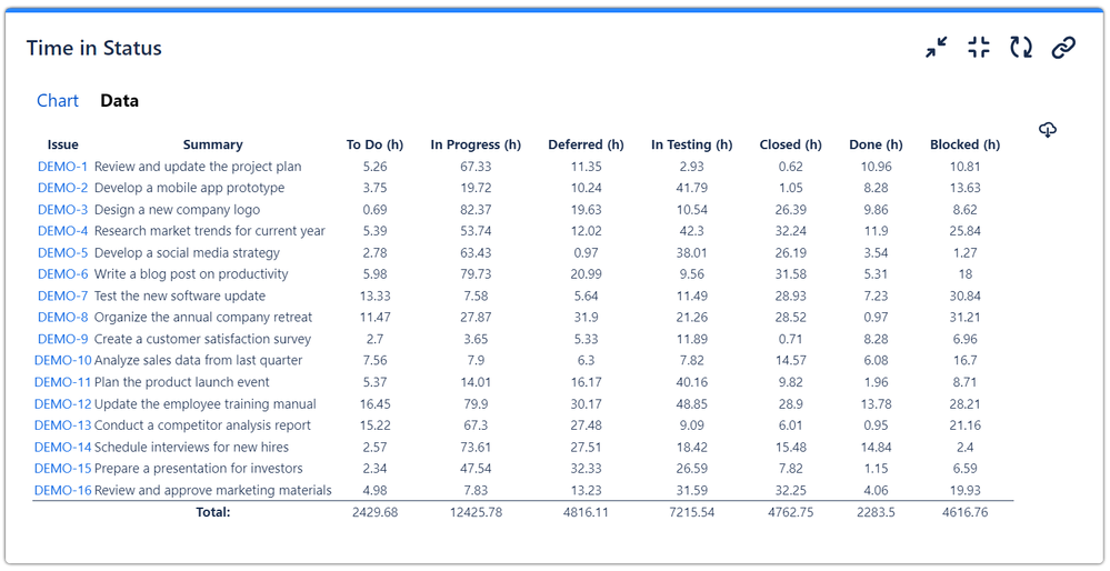

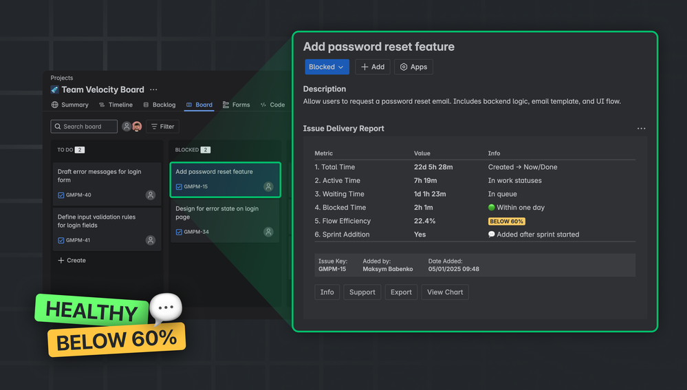

Maksym Babenko_TypeSwitch_
May 29, 2025
Hi @Claire Abt !
We ran into a similar problem on our team — especially with issues bouncing in and out of statuses like “Input Required” or “Waiting for Review.”
We’ve been using an app called Issue Delivery Report for Jira — it automatically tracks how much time each issue spends in each status based on the full changelog.
It shows you:
  • How much time was spent in each phase (like Active / Waiting / Blocked)
  • Flow efficiency (e.g., % of time in active work)
  • A breakdown of when the issue entered/exited statuses like “Input Required”
  • Who added the issue to sprint and when
Everything’s calculated automatically and shown directly inside the issue view — no need to dig through changelogs manually anymore.
Hope that helps!

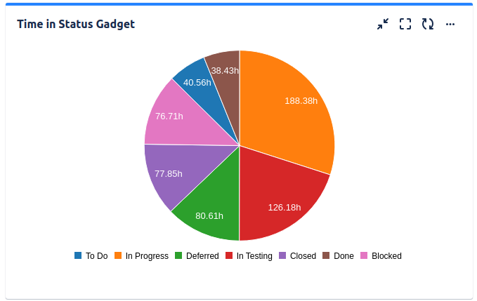

Danut M _StonikByte_
May 5, 2025
Hi @Claire Abt,
Welcome to the Atlassian Community.
The Jira's Control Chart report could be a option. It can show the time in status for individual issues. And I think you control the issue displayed in the chart, by using its "Quick filters" option under Refine report section.
For something better, you could look for an app on Atlassian Marketplace.
In case you want to try an app, our Great Gadgets app offers some gadgets that could be useful for your use case.
Control Chart gadget - similar to the Jira's Control Chart report, but more advanced and highly configurable. Allows you to specify a JQL/filter with the issues that you want displayed in the chart. You should configure it to calculate the cycle between entrance in "Input Required" status and the entrance in a difference status or status category.
On its Data tab, it can display the list of individual issues and their cycle time. Can exclude weekends from the calculation.
Time in Status gadget - lets you measure the time in status for issues in a JQL/filter.
On its Data tab, it can display the list of individual issues and the time spent in each status. can exclude weekends from the calculation.
If you have any questions about these gadgets, feel free to contact us directly at support@stonikbyte.com.
Danut.
