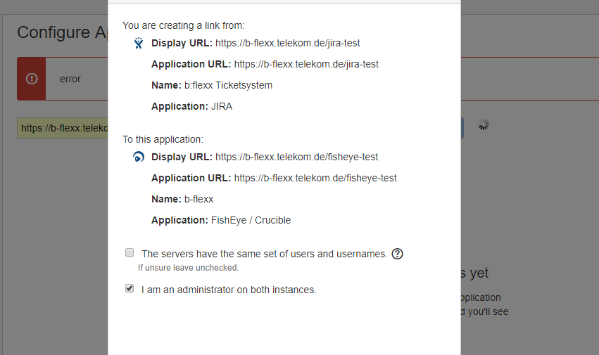

Everytime that I try to create an “application link” between Jira and Atlassian to make commits available in the tickets I have the following message:

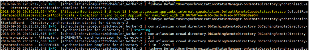

 Checking the logfiles of the instance I have the following lines:2.png

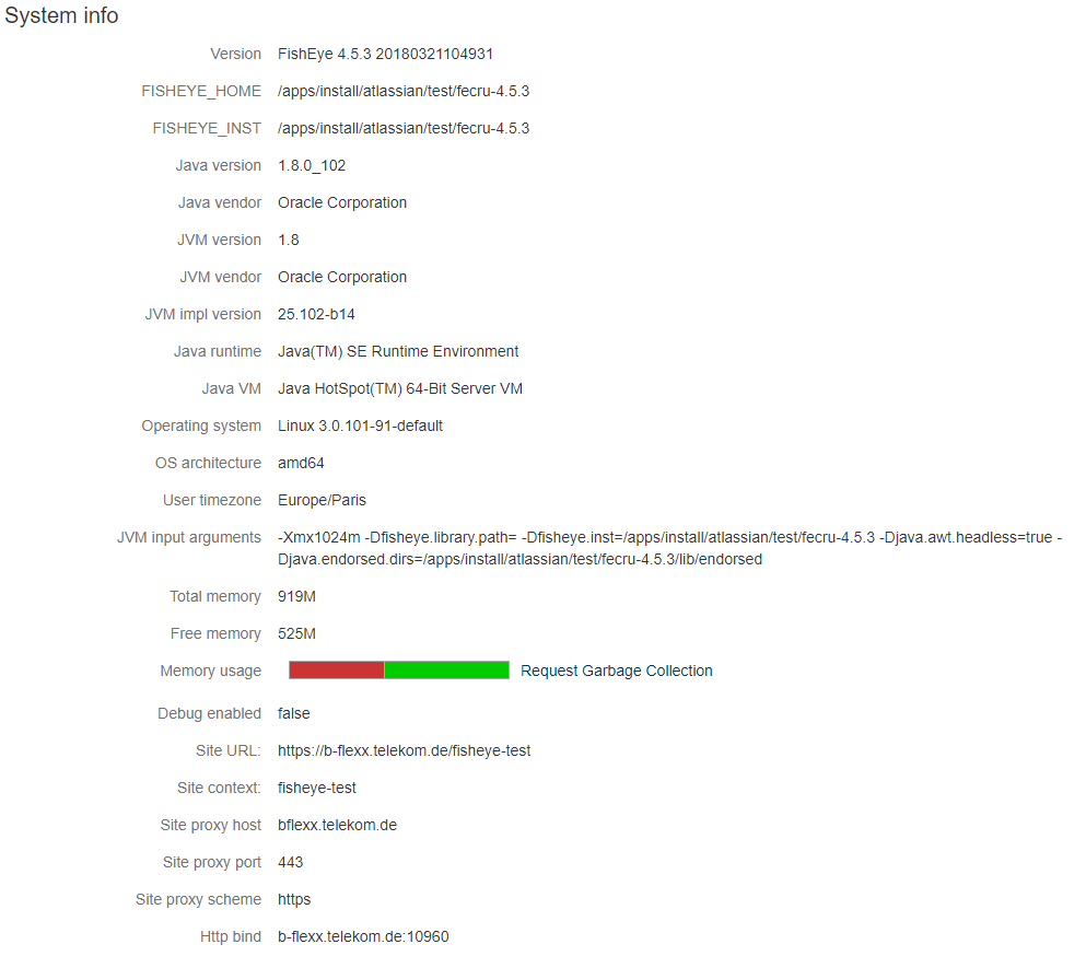

This is the only clue I have found in all log files. The Fisheye version we are using is 4.5.3, and the system infos are shown in the screenshot below:3.png

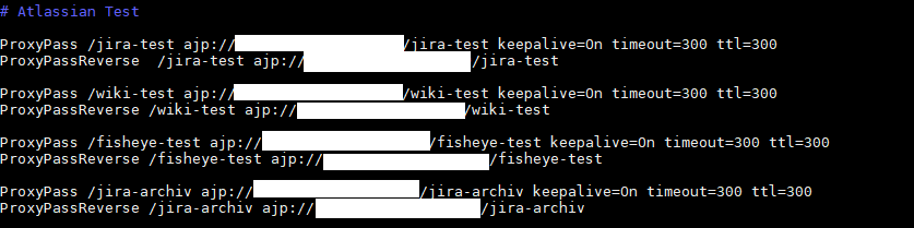

The access to Fisheye is done through ProxyPass, and the configuration of the Virtual Host and the ProxyPass statement are in the printscreen below:4.png
