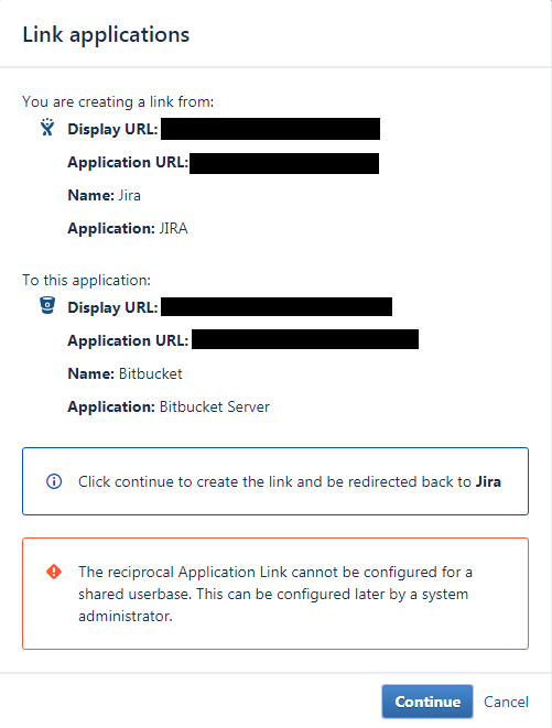

The reason I'm saying this (and why I'm not stating Bitbucket there) is that for Bitbucket I was able to "initialise" the application link for JIRA<>Bitbucket (and also Confluence<>Bitbucket). However, once the reciprocal in Bitbucket was to be done, I got an error message like the following picture.
But as stated, signing in with my INTERNAL superadmin on Bitbucket (idk why this separation is apparently not possible on the other applications) and manually fixing the mismatch for the authentication methods worked just fine.
This leads me to assume that after that initial definition the application link is not tied to any specific user. Aside from that, it would basically be impossible to know that you should not delete "Sysadmin No3" because he created the link a year ago.
