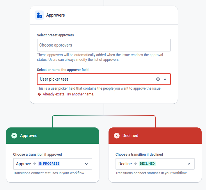

I'm trying to implement approval step on "To do" status and getting this error:
JWM don't allow me to use my custom user picker field that i created for approval proccess.
It looks like it requires to use it own field, which i should create on approval step. But i can't find this field anywhere to add it to task fields.

It looks like it thinks you are trying to create that field instead of just use that field. If you clear out the value and the click the dropdown and then start to type a few of the letters in the field, does the field come up so that you can select it?
No, field doesn't comes up. I assume that it wants me to create new field for approvals and doesn't allow to use field that already exist in task configuration (it says already exists when i'm typing exact name)

Is this a Team-managed project? If so, have you tried it with a Company-managed project?
Also, I would submit a support ticket to Atlassian for their feedback on why the field is not showing up.
https://support.atlassian.com/contact/#/
It is team-managed project. Approvals not supported in company owned projects right now.
