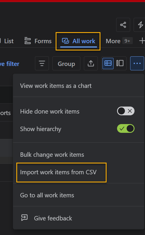

One option you could explore is the 'Import from csv' feature. This will allow you to export work items (issues) from a project into a csv file and then import them into another project / instance.
You'd need to ensure the fields were the same in both projects to ensure the data can be mapped.
You can Export the Work Items (Issues) from a Jira Filter, selecting which data you need to bring over (Export Excel CSV all fields). This method means you essentially have a backup of your data and can retain the data in both instances (you'll need to manage comms around cut-off dates for adding any new Work Items to the current project.
To Import, you'll need to select the 'All work' tab in your project, click the ellipsis and select 'Import work items from CSV':
You'll then need to follow the set up instructions for mapping fields etc.
Hope this helps,
Julia.

@Julia Watson-Clarke , thank you for that suggestion. Unfortunately that is not an adequate replacement for the current use case.
I should've stated the use case up front, and I will edit my post accordingly to add that.
