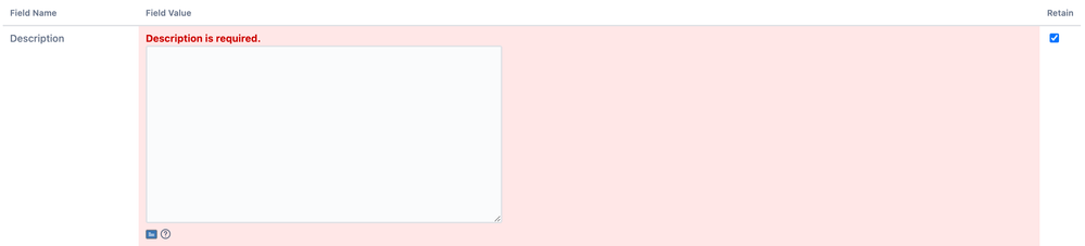

Hello! I am migrating over 300 stories from one project to another. In Step 3 of the Bulk Operation process, it asks to update the "Description" field. Underneath the "Field Value" column is a blank box, but most of our stories have content in the Description.
Whether or not I click the box under "Retain," an error comes up that says "Description is required." If I put something inside the blank box, will it replace the Descriptions that are currently on the stories? I want to make sure we do not lose that content.

Hello @Abby O_Connell,
This error means that Description is set to be required in the destination project field configuration and some of your stories don't have Description. If you click Retain and type some text into the form, this text will be added only to stories without Description. No data will be lost for those stories which already have Description filled.
You can also just temporally set Description optional in the destination project field configuration and move stories safely without adding any default Description.
If any of the issues you have selected for bulk move have a blank Description field and the destination project requires the Description field then you will get that prompt.
Unfortunately, if you do enter something into that field it will be written into all issues that a moved during that session, overwriting whatever was already there.
You will need to change your filter to select all the issues you want to move that also do not have a blank Description field, and move those first. Then you should not be prompted to fill in the Description field during the move.
Then you can do a second bulk move for the issues that do have blank Descriptions, and fill in the prompt once for text to be added to all the issues you are moving at that time.

I've run a test and it worked correctly with the selected option Retain. No data was overwritten in issues.
