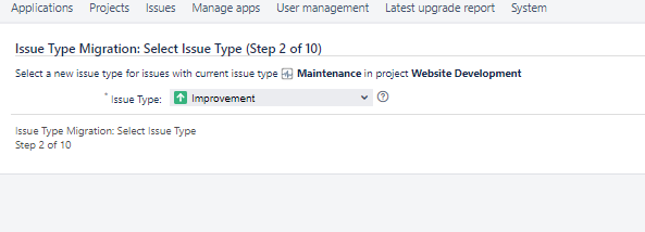

I'm running into an issue with migrating issue types when attempting to associate these to a new project. I haven't come across the issue before and I'm unsure how to solve it.
So I've created an issue type scheme and added the Issue types I want to be associated with the scheme.
When I attempt to associate this with the Project in step 2 of the migration I select the new issue to migrate to.

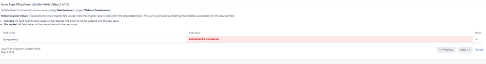

But then I run into an issue with the components
Any help in how to progress or steps I need to take to rectify this would be great.
It looks to me like components are set as mandatory for the target project and issue type, but optional for the source.
Check the field configuration for the target.
Hello @[deleted] check that the project has at least one component created. Once it's there instead of complaining it should allow you to select it and move forward.
The other option is to have a field configuration assosiated to the new issue type and mark the component field as optional.
Hi @Hernan Halabi - Elite IT Consulting Group thanks for responding.
There were already components in the Project active.
The component field is already currently optional
I've also associated the appropriate screen to the components field config
Though my apologies, the Project isn't new, it is an existing project.
I'm trying to create a new 'create issue screen'.
I had no issues with a previous Project we changed.
As @Nic Brough -Adaptavist- mentions, you should check the target project rather than the active one. If all is happening in the same project, check the field configuration that is assosiated to the target issue type.
