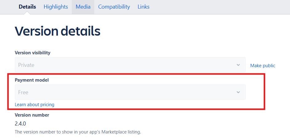

I created a new app in atlassian marketplace, that also got approved. However, since the beginning I try to change the payment plan from free to a paid plan. However free is always greyed out and I can not do any changes. Also created a new version now, and still can not change the payment model:
Online I only found some outdated documentation, where it says I need to go to the payment tab. However, as you can see there is no payment tab.
Can anyone help?

@stoffander The first check to make is whether you enabled licensing for the app. I assume you develop with Forge, and if so, see the `licensing.enabled` flag in the manifest.
If it doesn't support Atlassian Marketplace licensing, you can't set it to "paid via Atlassian", for obvious reasons.

That was the issue! First it was counterintuitive that I have to declare it in the manifest file, but after reading the docs it made sense! List a Forge app on the Atlassian Marketplace
I hope they will properly show a warning in the Version Detail UI in the future for better usability :)
