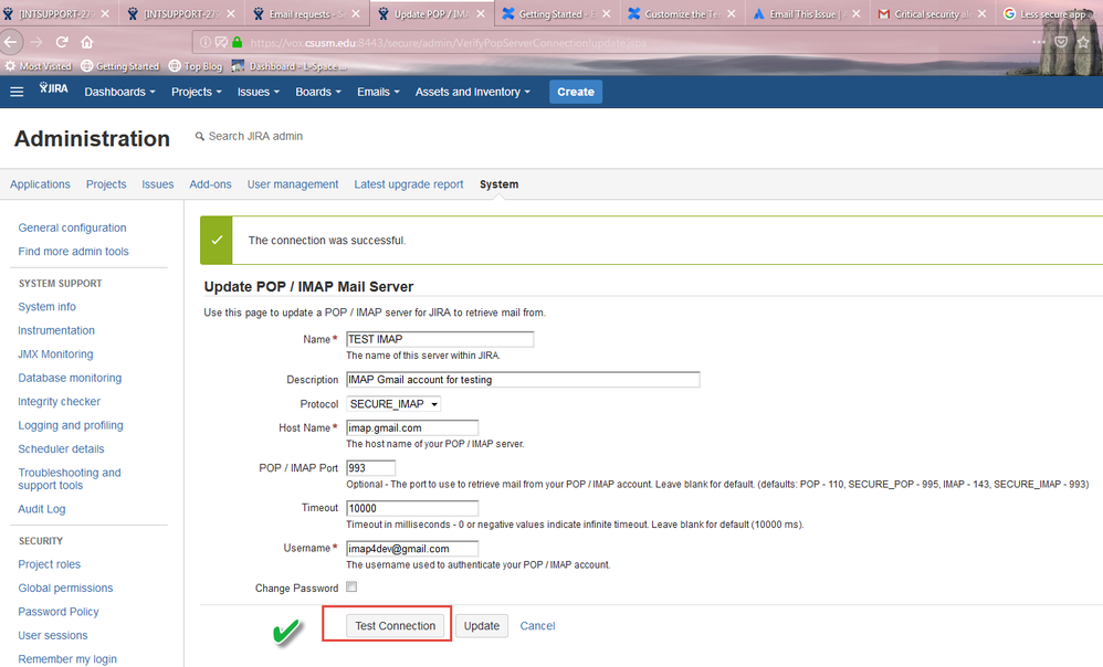

We've noticed our email haven't been coming into our JIRA Cloud instance. I first of all checked the POP / IMAP Mail server we have setup to suck emails out of our GMail host using the 'Test Connection' button. It however failed with the 'AuthenticationFailedException: [AUTHENTICATIONFAILED] Invalid credentials (Failure)' error (see below).
I then thought someone must have changed the password so I logged in to the GMail website using the credentials but that was OK and let me in.
I tried entering the password into the JIRA form again clicking 'Update' to save it regardless of the failed test connection but the emails remained unread in the inbox.
I followed the instructions I found on https://confluence.atlassian.com/jirakb/authenticationfailedexception-when-connecting-to-gmail-as-smtp-server-744723578.html but the account does not have 2 factor authentication and it does have "less secure access" enabled under the account.
Is there any way to further find out a more specific error, is this happening for other people or does it just impact our JIRA <--> GMail connection? It is difficult to tell which side of the interface is the problem.
Any help would be appreciated.

Hi Shannon,
Thanks for your suggestions, we're on on cloud hosting and I did try the 'display unlock Captcha' too.
We did get a burst of emails though yesterday, including many, many, many duplicates from single emails, but trying the test button now it still tells me that authentication failed.
Simon,
What if you change the username to the full email? Google suggests that here: Read Gmail messages on other email clients using IMAP

(I've accepted the answer but it was the comment under the answer that was the solution)

@Shannon S The link above (dated Oct 3, 2017) is useful for me. Particularly, the troubleshooting section (step 2) in the link says "Allow less secure apps: If you don't use 2-Step Verification, you might need to allow less secure apps to access your account". I follow the step and it works.

After enabling the less secure app access in gmail, I am getting an error that "Please login via web browser". Is there any other options I need to change?
Connecting to the mailbox...
Error : javax.mail.AuthenticationFailedException: [ALERT] Please log in via your web browser: https://support.google.com/mail/accounts/answer/78754 (Failure)

This worked after enabling 2 step authentication and created and used application password!
Worked like a charm.
