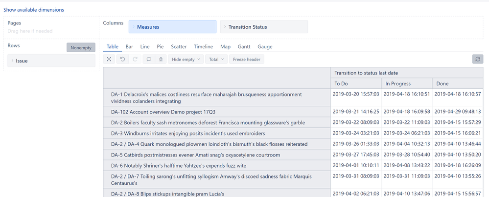

I would use eazybi plugin reporting for this, which captures the history that the transition were pushed.
You can then user additional measures (formulas) to calculate the diferences between completion dates and actual dates. It requires some training to use, but their support staff will guide you if you are stuck.
