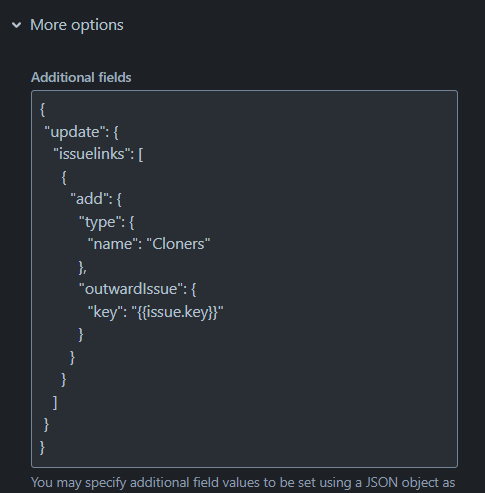

I have an automation rule that clones issues based on a custom field. It creates clones with the "Clones" issuelink type.
I need another automation that will also clone the issue and will create "relates to" link types. However, I cannot use the "Cloners" link type as another automation rule is linked to it. So, basically, the title of this post explains what's needed.
Here is the code used to link cloned issues. I believe I simply need to modify the code below to use the "relates to" link type instead of "Cloners". However, I'm unsure if this is correct and how to properly modify the code. Can someone help me with this?
If only the code below needs to be modified, please provide adjusted code for my case. Thank you!

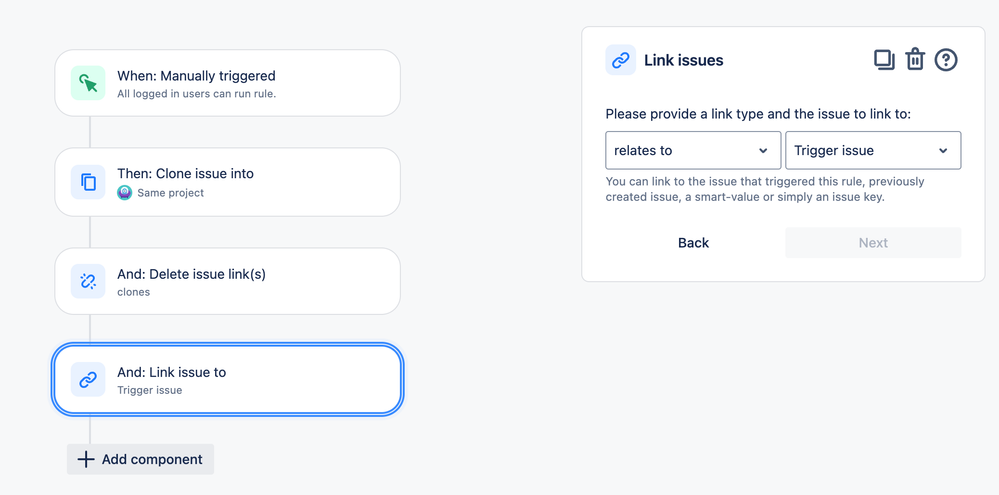

Hi @BenWade
Is there a reason why you do not want to handle it link below? Basically to remove the clone link and relink with a different type with additional blocks?

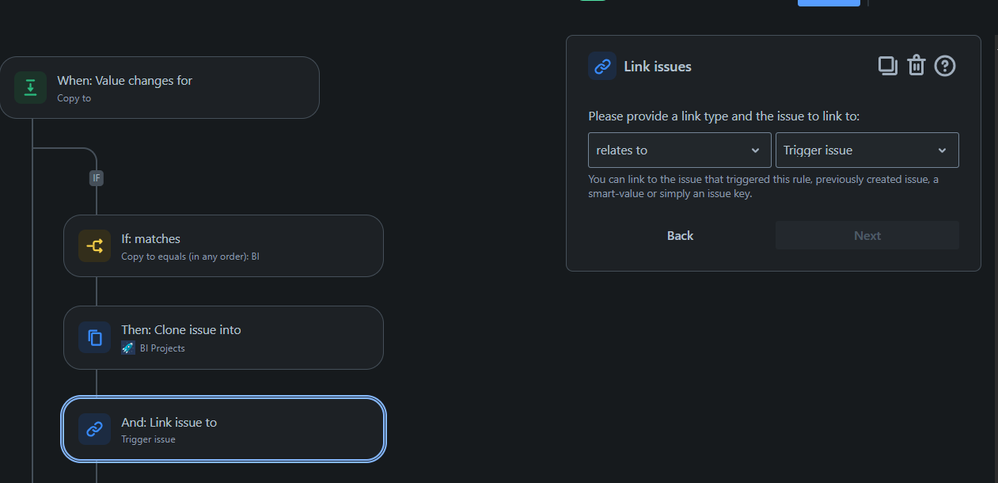

I have another automation in place. If the status of the issue in Project A has changed, then the status of the issue with issuetype link 'Clones' in another project will be changed as well. To avoid disruption, I need to use the 'relates to' issuetype link
I will chnage it now. But why 'trigger issue' does not work? It should work, no? Because the ticket in Porject A triggers the automation when I add value to 'Copy to' field
What is the 'Copy to' custom field type? Are you sure for the not triggered issues, the value equals to COMEX?
