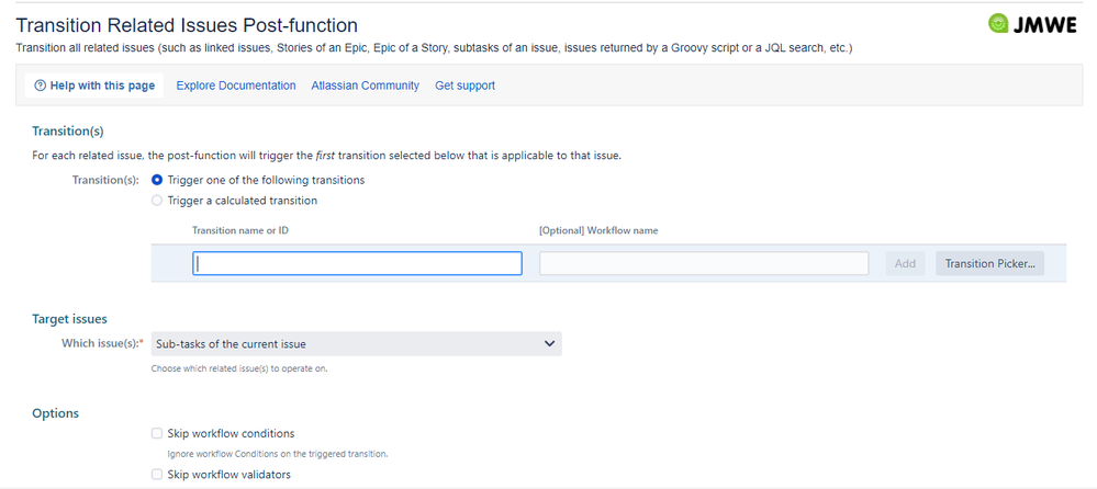

if you have JMWE, you can simply use a "Transition Related Issues" post-function, no scripting required.

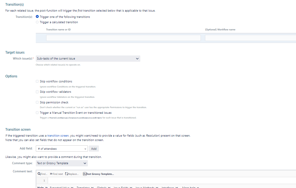

In the Attached attachment could u please explain how the fields to be filled for  "Transition Related Issues" post-function,

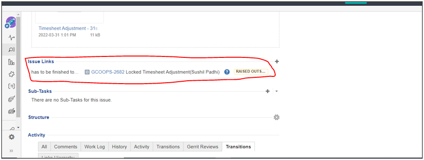

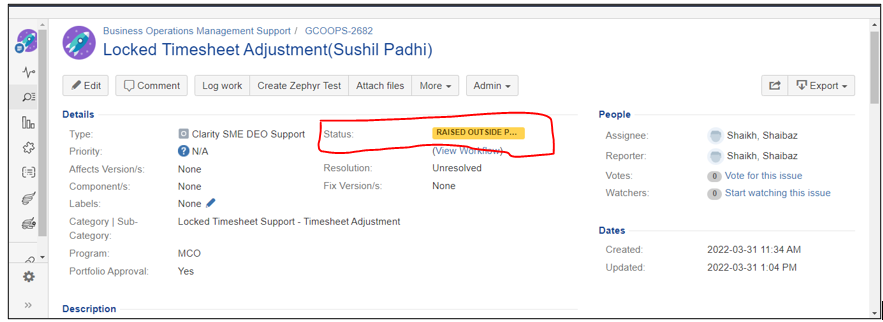

We wish to create a linking structure between issues of mentioned Jira projects in such a manner that if a "IMT" project ticket status changed to "Done" from any other status, the "GCOOPS" project which is linked to "IMT" Project based on issue link type "has to be finished together" ticket should also automatically change the status to "Done" which is in currently "Raised Outside Project" Status.

In the below Attached attachment could u please explain how the fields to be filled for "Transition Related Issues" post-function,

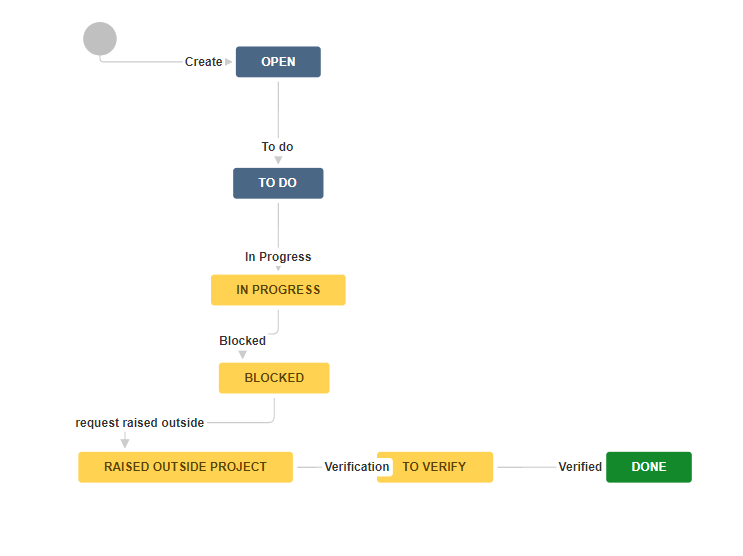

As per the attached screen adding the transition name or ID of the transition that takes GCOOPS issues from the "Raised Outside Project" status to the "Done" status is not possible as you can see in the screen that transition do not exists from the "Raised Outside Project" status to the "Done" status.
Is there any way to bypass the transition from the "Raised Outside Project" status to the "Done" status and status can be changed from "Raised Outside Project" to the "Done" to the linked issues
@[deleted]
The easiest is to add the missing transition and hide it from users by adding a "Hide from users (JMWE app)" condition on that transition. This way you'll be able to transition directly from Raised outside project to Done using the Transition Related Issues post-function, but users won't be able to.

Hi @David Fischer ,
The steps u provided its worked thanks from bottom of my heart..

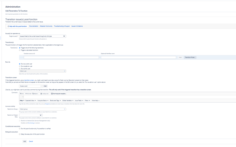

I am not seeing the option of Target Issues in this post-function. Could you please clarify on this. BTW I am using cloud version of JMWE plugin.
