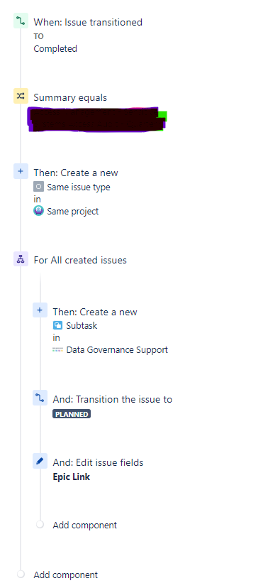

I have set up a rule to auto recreate a task and sub task within the parent task, I would like the sub task status to transition to planned in line with the Parent task how do I do this please ? I am using Team Managed next gen.

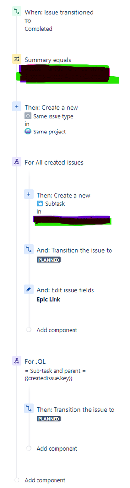

Followed those steps and afraid it does not work, it falls over on the JQL step, is there another way of doing this without using the JQL step ?

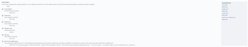

Darren, when you note it falls over on the JQL step, what do you observe happening and what do you see in the audit log? Thanks!
Sorry; my bad...it appears to be a bit more complicated as I just discovered...
{{createdIssue}} and {{createdIssues}} do not appear to return sub-tasks created in a rule!

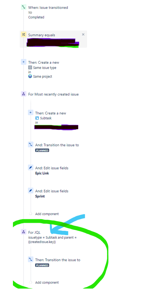

So here is the work-around for this which I tested and believe works as you asked:
Sorry but I am finding your instructions really hard to follow, are you able to take a screen shot of your example created please as I can't get it to work.
I don't know what the below means or how to create it, I am new to JIRA.

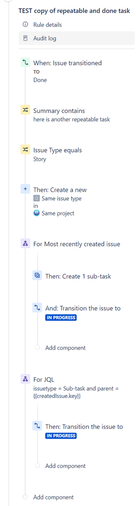

Hi Darren,
It appears you have a typo in your JQL for the branch. Here is an image of my test rule to do what you asked.

@Bill Sheboy Thank You however I still can't get it to work so just going to leave the sub tasks as new request status, when I enter the JQL it won't let me validate it, the validate button is greyed out, If I run it exactly as you have advised and it does not work the sub task stays as New Request so just going to leave this now I think. Thank You anyway unless you can expand the JQL branch showing me it has been validated and screen shot that for me.
Also just checking your doing this in Team Managed Next Gen ?
I tried this for team-managed and company-managed.
That JQL references a smart value, so you cannot validate it in the rule at design-time (which is why the button is grayed out):
issuetype = Sub-task and parent = {{createdIssue.key}}
We have extra issue types in our instance, so perhaps also check what the name of your issue type is for a "sub task". You may confirm this by running an example of that JQL stand-alone in advanced filter search, such as:
issuetype = Sub-task and parent = DGOV-424
I believe that was one of your tasks, correct?
