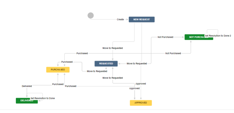

Our Purchase Request workflow needs to be updated so if users leave "None" selected in the "No Approval Required?" custom field, the issue will transition directly to REQUESTED.
Likewise, if something else (NOT None) is selected, the issue would go to APPROVED.
Currently, when the issue is created, its left at a NEW REQUEST status.
I have not had luck with setting up a 'condition' 'value field' - Do I need to utilize Script Runner? I have tried as well with no luck. Any help is appreciated, thank you.

Hi @Jo , I read your answer and I tried to perform the same thing on my project but it didn't work.
I think the reason is that the custom field value was changed only after the issue was created.
Is there a way to change status automatically when a value of a custom field is changed, even after the issue was created?

I selected the Project KEY,
However, when I create a new issue using Batteries, the status is not changed to Delivered.
