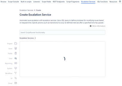

Vishal Tanna October 24, 2019
Hi Ravi,
My objective is to automatically transition any issue status from Resolved/Cancelled etc. to Closed after 5 days of inactivity.
For the same, I tried to follow the steps given in the documentation at https://scriptrunner.adaptavist.com/latest/jira/escalation-service.html.
I have installed the trial version of Adaptavist ScriptRunner for Jira v5.6.2
However, I am stuck at the first step of creating an Escalation Service. The loader just keeps running, and never brings up anything. Please refer to the below screenshot.
Actually, I have this same issue everywhere else too, such as 'All Categories' under the Browse tab, Built in Scripts, or even if I try creating anything else under either of the tabs.
Does this mean that my Script-runner add-on has not been installed correctly? What if I uninstall and try reinstalling? Would it still allow me to install the trial version for the number of days remaining?
Please help! I have been struggling with this over the past few days.
