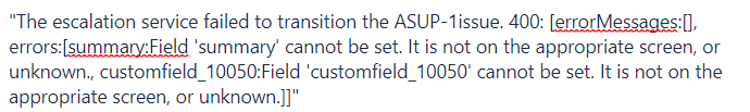

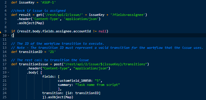

I've managed to solve this. I'm unable to use update custom fields in the transition as the fields were not available. I was unable to get the fields although I tried to change the screen types in workflow transition.
So I managed to use PUT method to update fields.

Hi Nic.. Thanks for the suggestion.. I'm trying to update the fields by using POST function when doing transition..
Please look at below script.
I got below error. Please assist.
