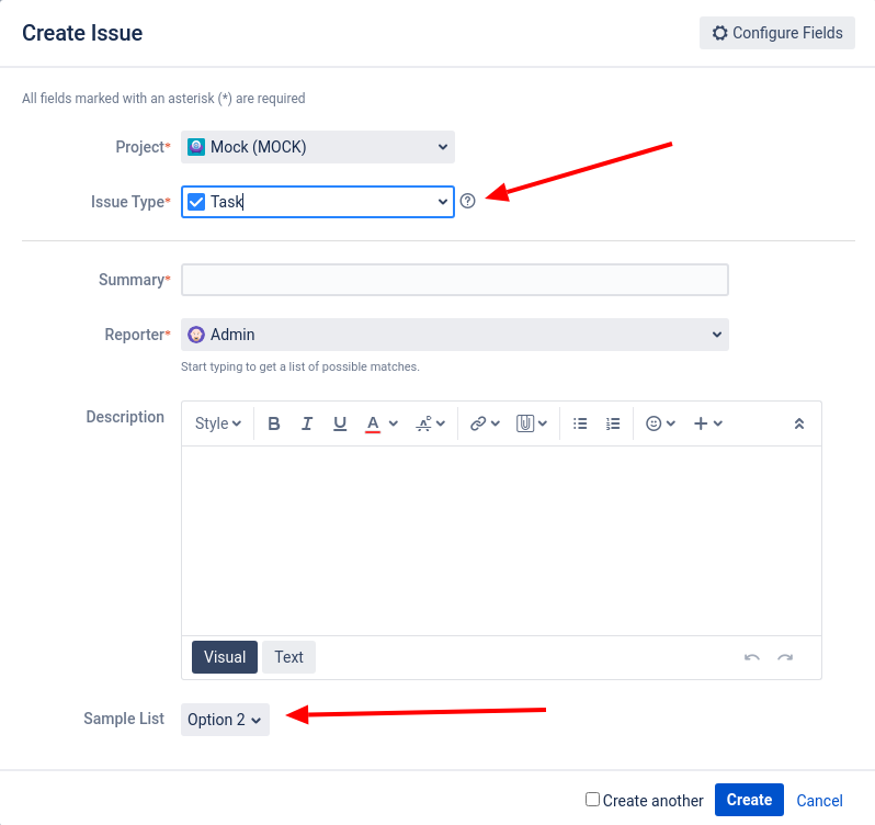

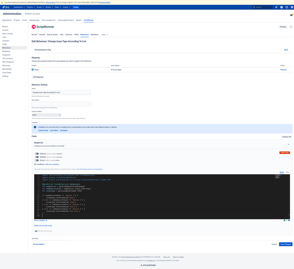

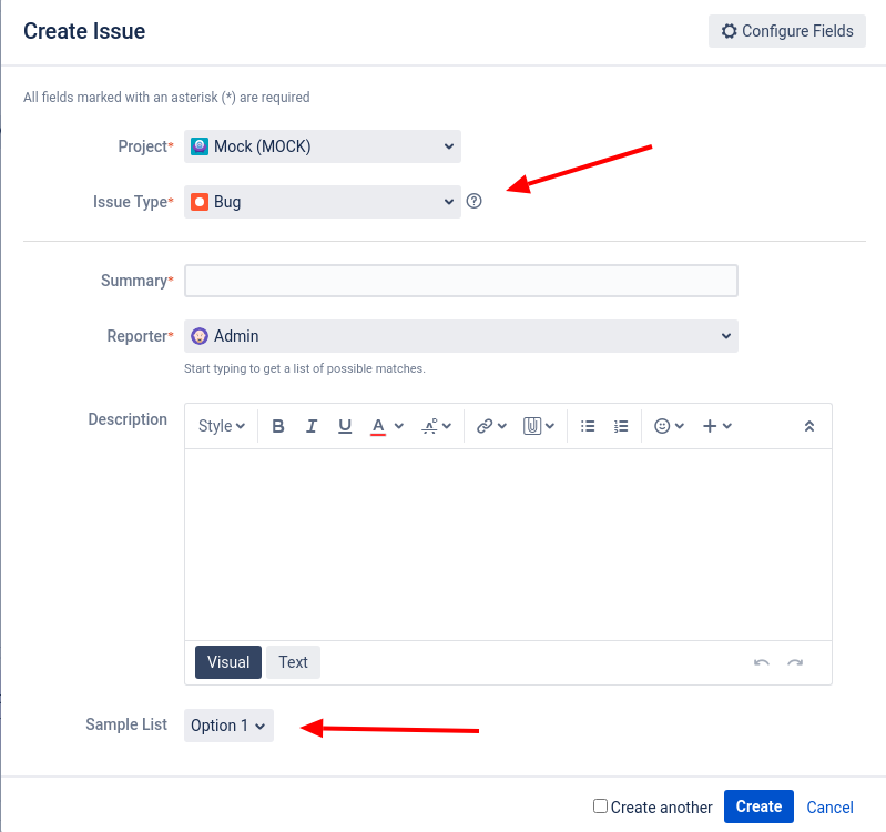

Below is the working sample code if you intend to change it to a non-Sub-Task issue type:-
import com.onresolve.jira.groovy.user.FieldBehaviours
import groovy.transform.BaseScript
import static com.atlassian.jira.issue.IssueFieldConstants.ISSUE_TYPE
@BaseScript FieldBehaviours behaviours
def sampleList = getFieldById(fieldChanged)
def sampleListValue = sampleList.value.toString()
def issueType = getFieldById(ISSUE_TYPE)
if (sampleListValue == 'Option 1') {
issueType.setFormValue('Bug')
} else if (sampleListValue == 'Option 2') {
issueType.setFormValue('Task')
} else if (sampleListValue == 'Option 3') {
issueType.setFormValue('Story')
} else if (sampleListValue == 'Option 4') {
issueType.setFormValue('Sub-task')
Please note the sample code above is not 100% exact to your environment. Hence, you will need to modify it accordingly.
Below is a screenshot of the Behaviour configuration:-
Below are a couple of test screenshots for your reference:-

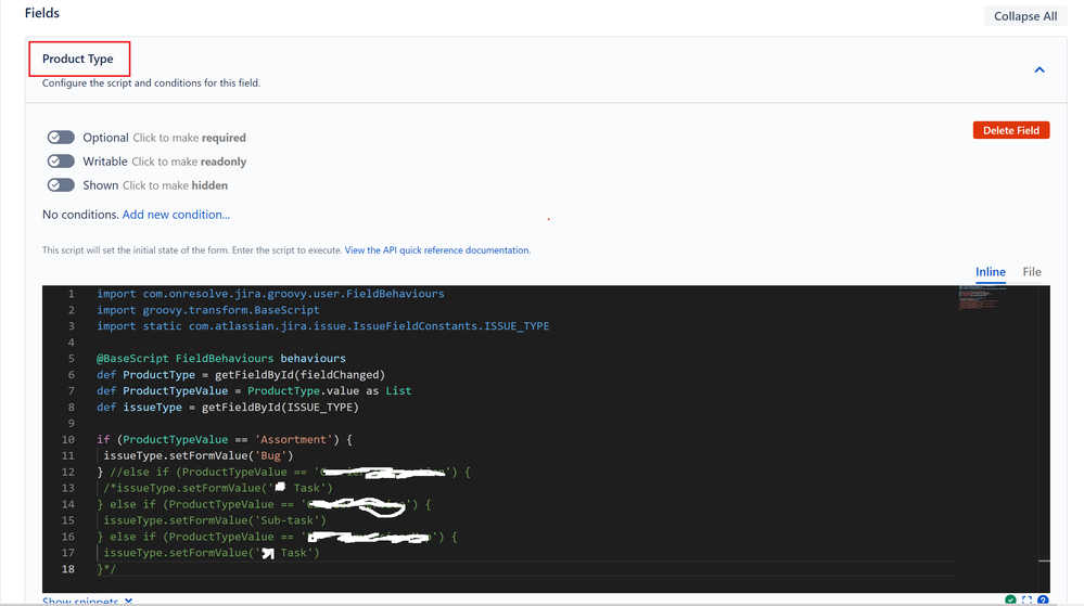

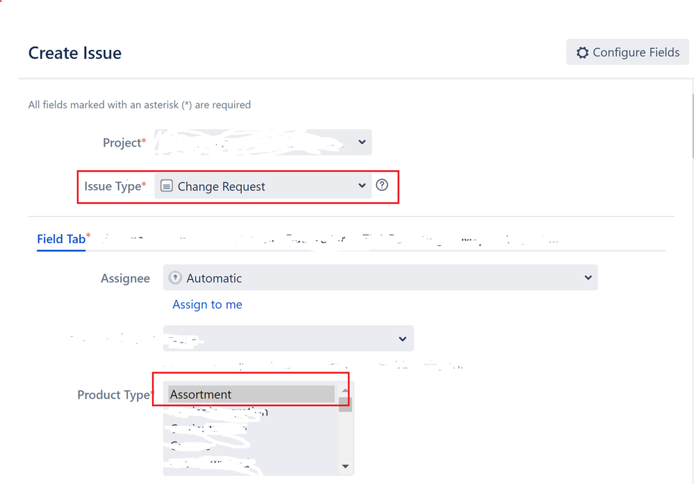

Hi @Ram Kumar Aravindakshan _Adaptavist_ ,
Its not working for me. Did I miss anything ?
Sorry I forgot to inform the field Product Type is multi selection list.
Please find attached screenshots for your reference.
In your case, you are testing with a Multi-Select List, not a single Select List.
But you cannot select multiple options from the List for this scenario. So it is pointless to convert the Multi-Select List value to a List as you have done, i.e.:-
def ProductType = getFieldById(fieldChanged)
def ProductTypeValue = ProductType.value as List
Instead, convert the Multi-Select List value to a String, as shown below, and it will resolve your problem.

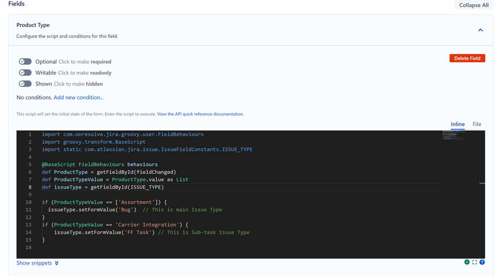

def ProductTypeValue = ProductType.value as String
However, if you still need to convert the Multi-Select List value to a List to get the Behaviour to work, you will then need to change the if/else condition to:-
if (ProductTypeValue == ['Assortment']) {
I hope this helps to solve your question. :-)
Thank you and Kind regards,
Ram
Thank you @Ram Kumar Aravindakshan _Adaptavist_ , Its working now, I was able to change the main (parent) issue type based on field value. There is no possibility to change the sub-task. This is our main requirement "Change the sub-task(we have 4 sub-tasks) based on custom field value) ?
Great to hear the solution worked. :-)
In your last comment, you asked:-
No, this is not possible. Using the Issue Picker is impossible to switch to a Sub-Task type as the Sub-task issue type is not displayed.
