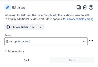

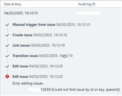

Idea 2:
User input is collected on the manual trigger, that stamps Parent on the original issue, which can then be copied to the new issue. (I'd actually prefer not to add a parent to the original issue since it shouldn't have one, but it seemed like I had greater potential to be able to do it, except that I haven't managed to get the parent field to stamp anyhow.)
