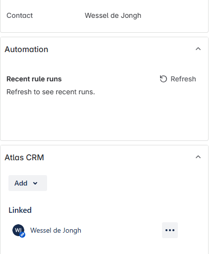

I want to add a rule that automates sending an email when ever a task is moved from 'progress' to 'to do'. I would like to link this with atlas CRM so when ever you choose a contact person and company it automatically sends a mail to them. This is how the CRM in connected to the task:

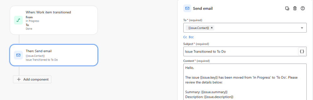

Now the question is how do I send an email to the contact in the issue? I have the automation rule set up like this for now:
I already got an error running this, so I know that {{issue.Contact}} is not correct. But maybe a better question is: how do I use smart values. I feel like there is not a lot of documentation on this to explore the topic. So how would I make sure the mail is send to the correct contact added to the task or/and how do these smart values work in general? Can they also use something from a third party like CRM?

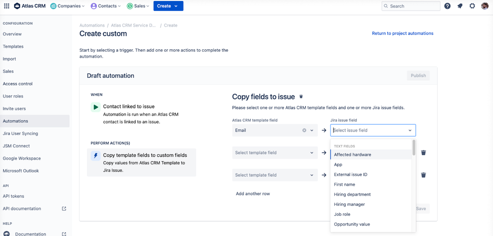

Don’t worry, there’s no need to switch to another CRM or an external service like Zapier 🙂. You can do this pretty easily by copying the email address from Atlas CRM into a Jira issue field using an Atlas CRM automation.Here’s how to set it up:
  1. Go to Atlas CRM → Settings → Automations
  2. Select the project where the issues live (the ones linked to customers)
  3. Create a new automation:
    • Trigger: When a contact is linked to an issue
    • Action: Copy the email address field from Atlas CRM into a text custom field on the issue (make sure this custom field already exists)
After you save this automation, every time a contact is linked to an issue, thecustom field will be filled in with the email address of the contact. You can then use the automation that you already sent in your screenshot to send the email to the contact.
Simply use the custom field {{issue.customfield_XXXXX}} in the to-field of the send email automation.(The custom field ID depends on your setup—you can find it in Jira's field configuration.)
