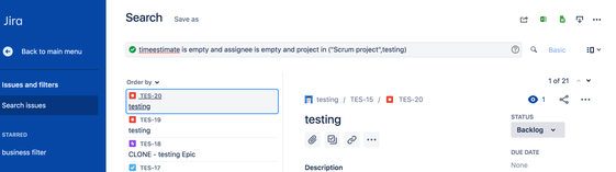

To create a global board, you can perform the steps below:
- Go to your issue navigator > Create a filter to return all the issues you want > Save it with the name you want
- Back to your project, click on the board drop-down > Create a new board
- Select to create board from an existing filter and select the filter you created, following the steps of the client to configure it as you need
