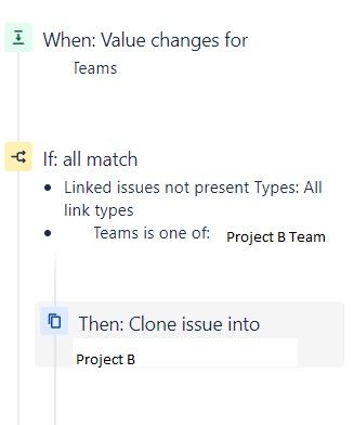

I've created an automation in Project A to create a clone ticket in Project B
In my automation in Project A, I wanted to assign components in the CLONE ticket but the components are available in Project B only. I've created the same components C & D from Project B to Project A.
In Project B, they have 3 Kanban Boards and component C & D is equivalent to Kanban boards C & D.
How do I make my automation to CLONE the ticket in Project B, Component C/Kanban C board only? It's currently showing in both Kanban boards C & D.

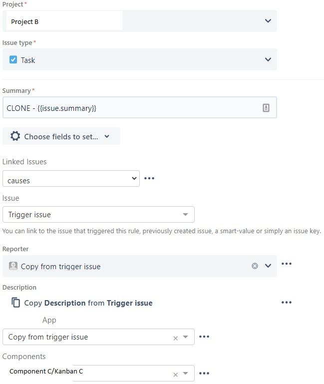

Automation created in Project A to clone in Project B:
Automation Clone issue to Project B:

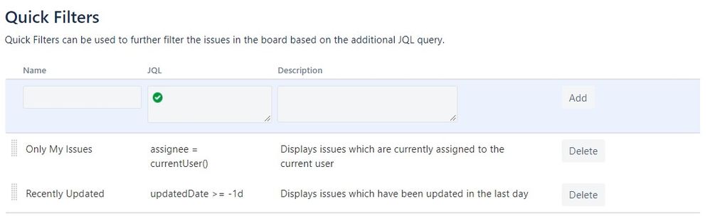

Component/Kanban C & D Filters:
