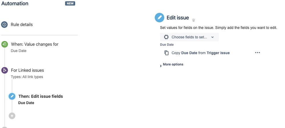

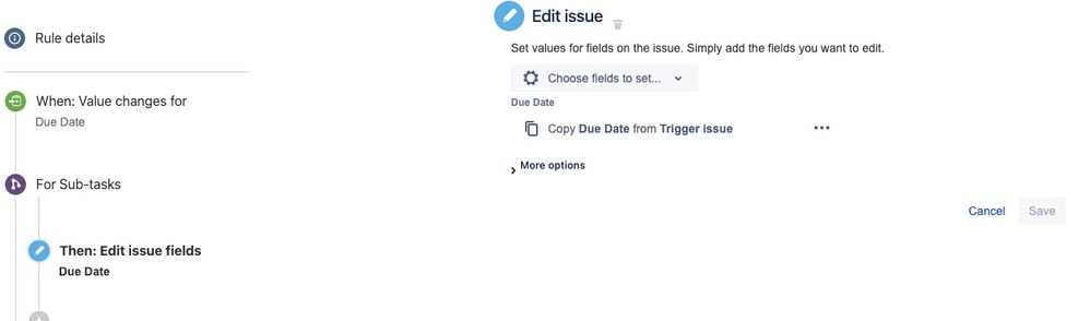

You'll need two rules for this because it is not possible to dynamically query for all linked issues and their sub-tasks in a single query. Here's a quick overview of the rules:
Rule #1
Rule #2
NOTE - For Rule #2 to trigger, you will need the Allow Rule Trigger checked:
Rule 2 is working fine.
Rule 1 is clearing the due dates of all the related issues.

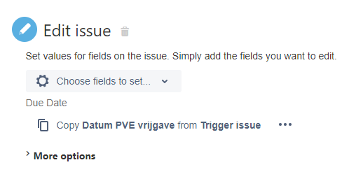

For Rule 1 i need to be a bit more specific. In the parent issue we use several dates:
date PVE vrijgave
date Concept vrijgave
date R&D vrijgave

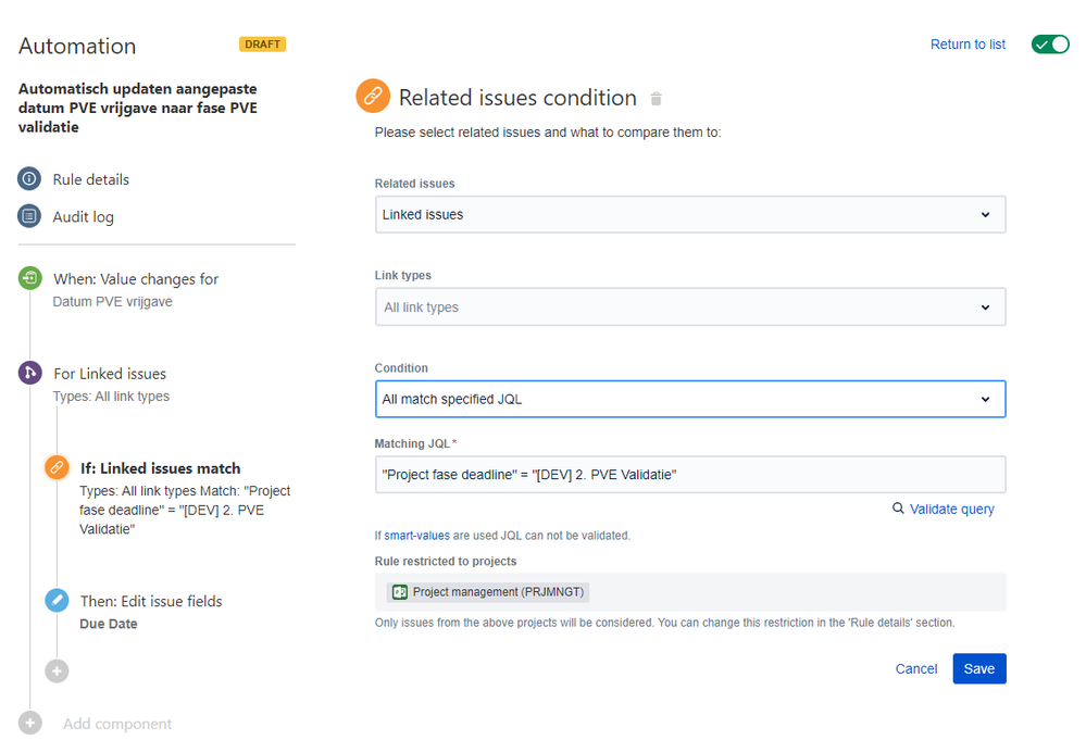

Each "vrijgave" is a related issue. So i need to make an automation rule for each related issue with the specific "date xxx vrijgave" as trigger.
If someone changes one or more dates this needs to change the due date of the specific "vrijgave".
I found a solution using an extra condition "if project fase deadline equals" in stead of "if: linked issues match".
