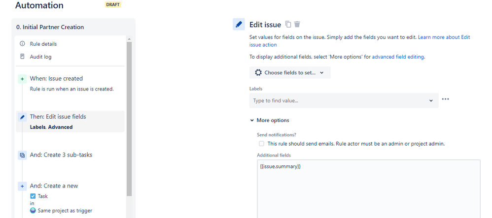

Sabrina Sykes-Gelder September 18, 2023
Hi Mathew
Thank you for responding - I can't seem to get this to work when I create my first issue, I am sure I am missing something really easy/obvious!

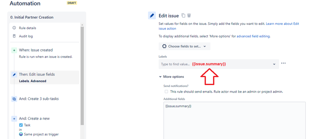

Sabrina,
No problem. Typically with labels you want them to be limited to a pre-defined list otherwise your list of labels can get a bit out of control.
To do what you're looking for however, you should be able to type {{issue.summary}} into the Labels box. Jira should recognize you're trying to use a smart value and accept the entry.
Unfortunately that doesn't seem to have worked.

Could that JSON error come from the advanced edit you're trying to perform?

Based on your screenshot, on the left side bar it says When: Issue Created, Then Edit issue fields Labels, Advanced. I don't see a field called advanced, so I assumed you were trying to do some additional configuration programmatically which would explain where the JSON errors are coming from.
I would suggest trying to create a new rule and starting with the most basic options, try to build out what is needed one step at a time.
  • When: Issue Created
  • Then: Edit issue fields: Labels
Start there, see if that works. If it does, start adding more to it like your sub-task creation.
Sabrina Sykes-Gelder September 19, 2023
That is fab, I must have been doing something else which was causing an issue.  This seems to have worked - yeah!!
Thank you so much for your assistance!!!
