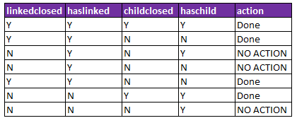

Situation: We have a project A, where users creates epics an these epics could be:
1. Epic-> child issues
2. Epic-> linked issues from same project or other projects
3. Epic -> child issues
So, first of all, I need to know:
1. has the epic child issues?
2. has the epic linked issues?
3. if the epic has child. are all child issues closed?
4. if the epic has linked issues, are all linked issues closed?
Saying that, I created 4 custom fields, haschild, haslinked, childclosed, linkedclosed. All fields with default value set to NO
Now, first two automations:
On Project A, I created one automation,
Trigger event: On create issue
Condition: if parent exists then haschild
Branch: for epic parent set haschild to Yes
As a multiproject rule:
In rule details. select all the project that are going to be involved to project A
Trigger event: when issue linked
Branch: for linked issues (all types), set haslinked to Yes
Last an more important rule
as a multiproject rule: close epic
In rule details, select all the project that are going to be involved to project A
Trigger event: when issu transition to Done
Branch: For epic (parent)
Condition: stories (or other issues in this epic) match jql Status = Done
then childclosed =Yes
if issue matches JQL : haschild, haslinked, childclosed, linkedclosed
(linkedclosed =Yes and haslinked= SI and childclosed= SI and haschild=SI) or (linkedclosed=SI and haslinked= SI and childclosed= NO and haschild=NO) or (linkedclosed=NO and haslinked= NO and childclosed= SI and haschild=SI)
Then transition to done
Condition: all link types match Status =Done
Then linked linkedclosed = yes
So the scenarios that I have tested are:
Hope this helps!
Ro
