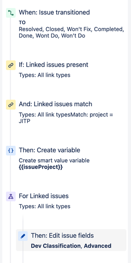

I'm doing an automation that should set a the value of a custom field based on some text that is dynamically extracted.
I can't get my head around how to update the value of the field.
The key of the project is extracted correctly and is present in the multi-choice options, but I don't know how to select the option that matches the text from the smart value.
Any ideas?
This is how I do the update:
"fields": {
"customfield_10453": {
"value": "{{issueProject}}"
The above doesn't work, however with a hardcoded value it works
"fields": {
"value": "MC"

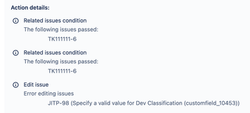

Here is a proof I have it in the multi-select:
And here is what the Audit log says
Please use a Log action to print the value of your variable in the Audit Log.
If TK111111-6 is the issue that is triggering the rule, and
If you are setting the variable to {{issue.key.substringBefore("-")}}, then
The variable is getting set to TK111111, and
TK111111 is not a valid value in the selection list for which you provided an image.
