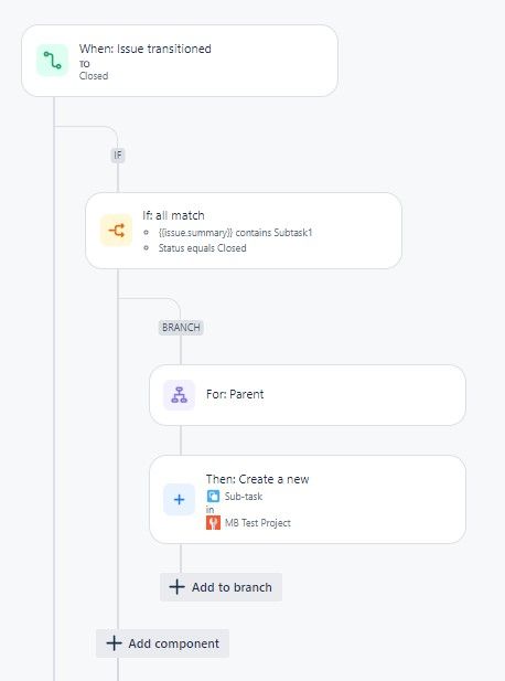

I have been successful in creating a Subtask when a single Subtask has been Closed, using the below automation;

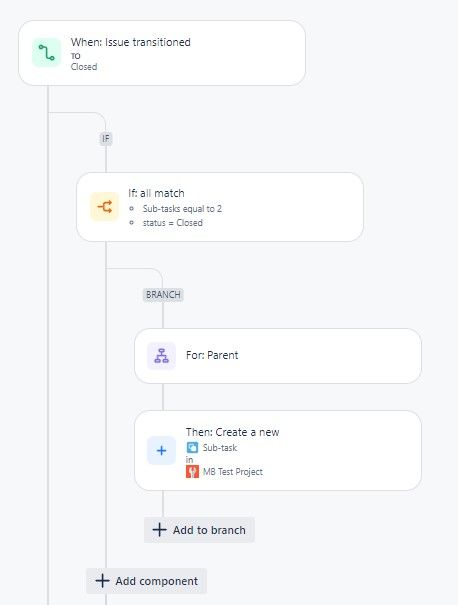

I attempted to follow https://community.atlassian.com/t5/Jira-questions/How-to-automatically-create-a-sub-task-when-other-two-sub-tasks/qaq-p/2343674 but didn't appear to have the same options to select from, that had been suggested in the comments. So, I ended up with the below automation (which isn't running at the point that I close 'Subtask1' & 'Subtask2');
I presume I've misunderstood a step, or have entered something incorrectly, but just can't get the automation to work. Any help would be great! Thanks

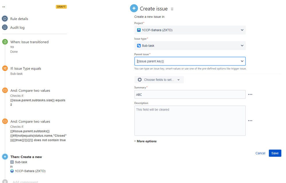

Assuming that the creation of the first 2 sub-tasks at the point of issue creation is good/ you have implemented,
You can create the subsequent third/fourth based on your requirement like below:
The syntax to check if all subtasks are done is:
*NOTE - The bolded part in above needs to be changed to your final/terminal state of Sub-tasks and it has to match exactly. That is, closed != Closed. So please confirm that.
Please implement above, try it and share if issues. Thanks!
I think this has worked! On closing the first 2 subtasks, a 3rd subtask has been created.
I need to do some further testing that this works for the Project I'm configuring, as there are a number of other similar automations required for different Issue Types and Subtasks, but I think this should be what I need.
Thanks a lot for your help!
Glad to hear. Yes, please test. I created only 1 sub-task in my screenshot. You can add 1 more. And then test closing the third subtask and verify this rule does not create any more etc... Do let me know if any clarifications..
