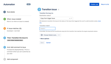

@Paul Farrell - just to help with your use case a little, you can set up an automation rule that looks something like below. Feel free to shoot through any questions when you are giving it a go. Best of luck!
