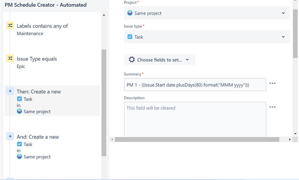

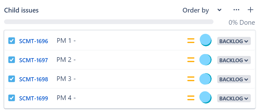

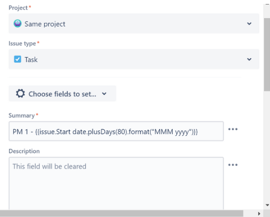

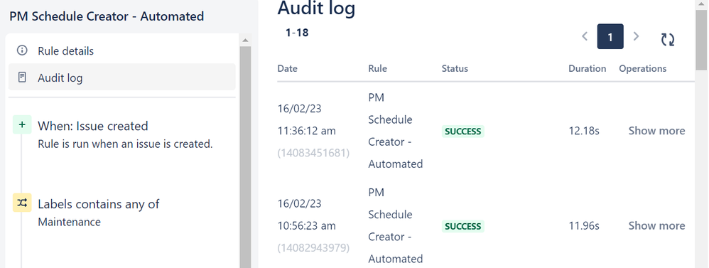

I created a few automation rules to complete custom date when the issue is created. For example input the field Start Date, label must be Maintenance and issue type equal Epic when the issue is created.
The audit log shows successful but there is no date in the field. Any ideas why it's showing successful but the data isn't populating?

hi @Tasya Febriany
most probably because the start date field value is empty. i would recommend to use issue.created instead of issue.Start Date.

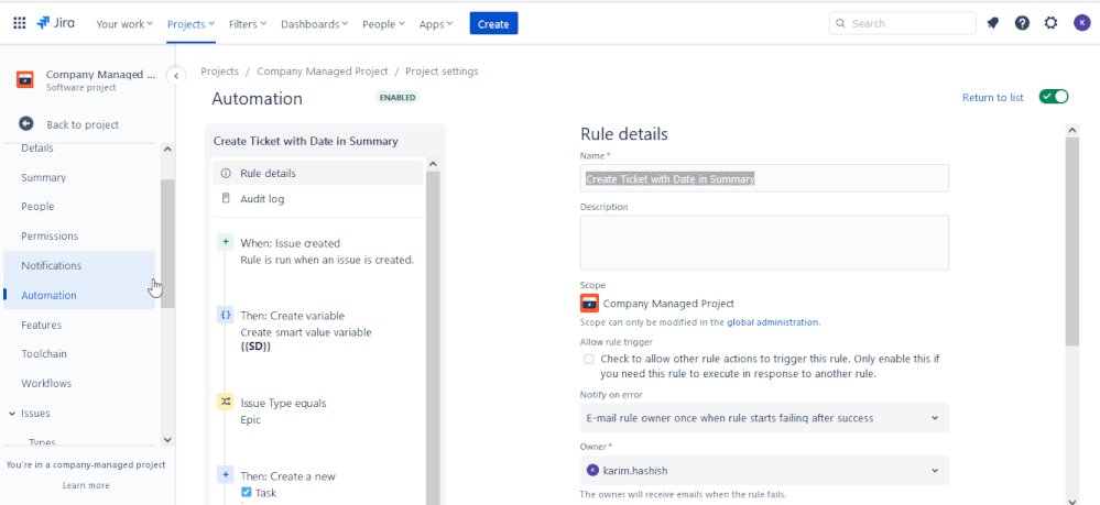

Good Morning @Tasya Febriany

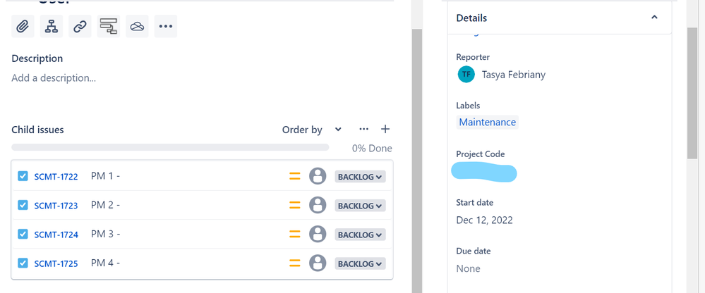

In fact the start date your are using in the function is referring to the Start Date of the task not the EPIC.
In order to solve that, you could store EPIC start date in a smart value then use it in your function --> check the illustration below
Let me know how it went for you.

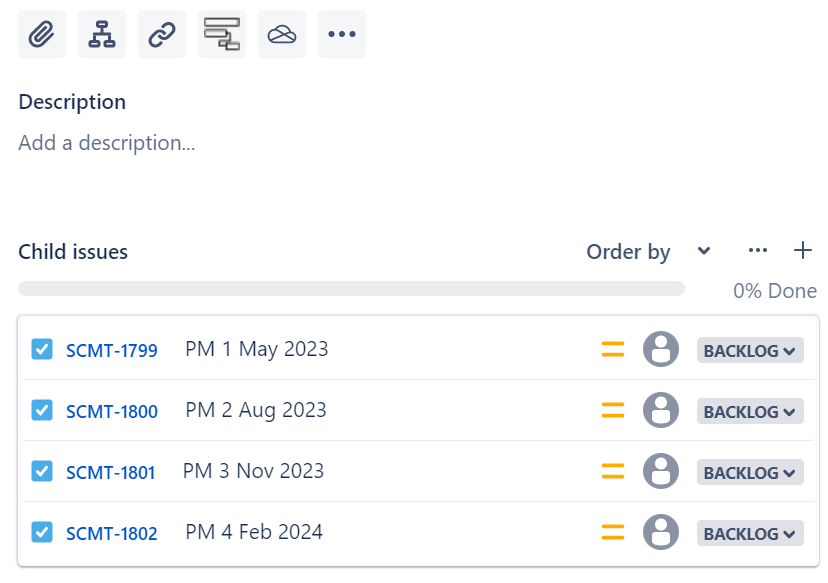

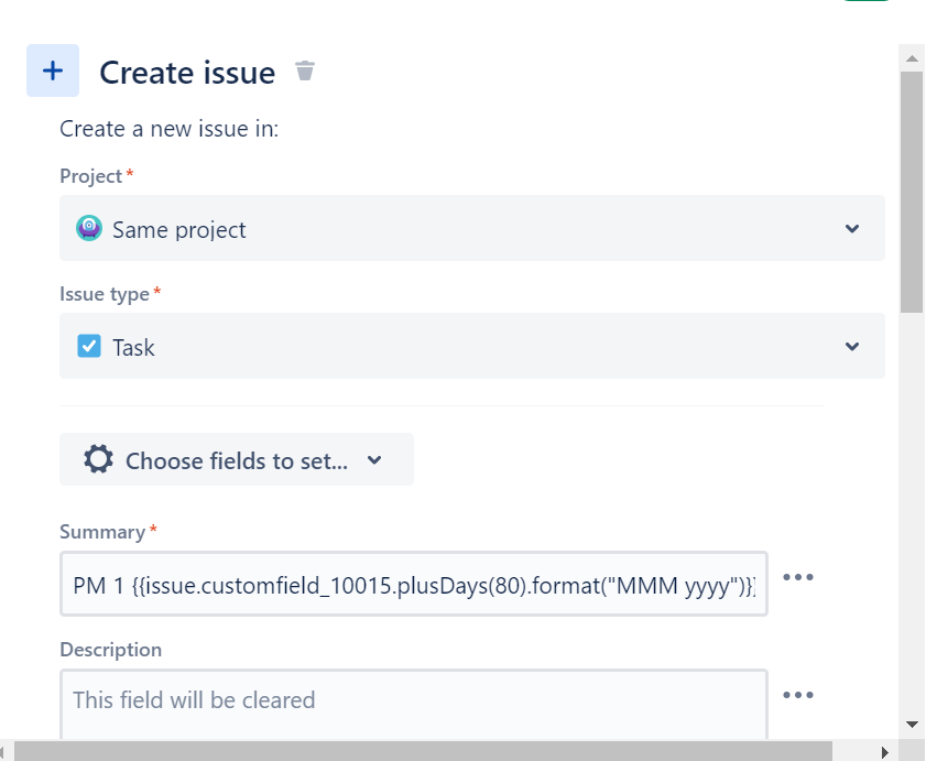

Thanks @Karim ABO HASHISH
I change the part of smart value from issue.Start date to issue.customfield_10015 and it worked!

If, in the audit log, you click on the option, "Show more", you can see how the rule was processed, which can help in a case like this where the issue should meet the criteria but the action isn't happening.

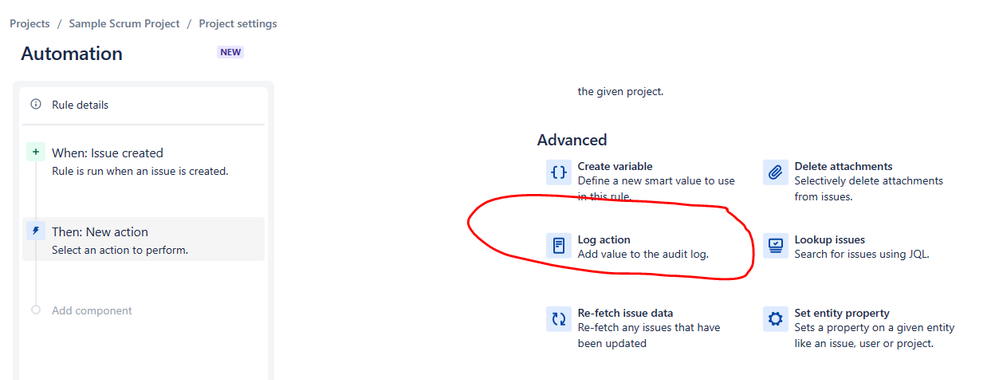

Something else you can try for troubleshooting is to use the "log action" action to check that the smart value is working. Again, if you go into the "Show more" you should be able to see if the correct value is returned in the smart value, and then it's just to understand what / if something else isn't configured correctly.
There is a reserved field called "Start date". I tlooks like all attempts to use that field result in a blank outcome in automation - even when a the field has a value.
I suggest using a differently named field.
