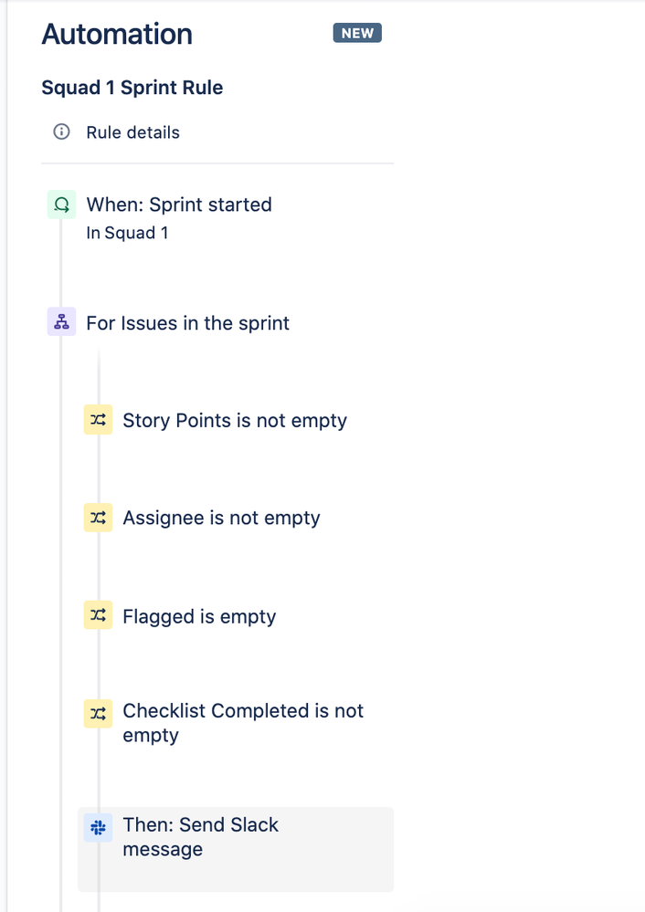

Hi.
I'm looking to add some automation in for some of my sprint boards. In short I want Jira to remove any issues that do not meet the Definition of Ready (have SP and an assignee added, and have the DOR checklist completed) when a sprint is started. Ideally I would also then trigger a message via web hook to the Slack channel.
So far I've managed to do this (see screenshot below), but struggling to work out how I can add an action which removes the issue from the sprint. Any ideas?

To remove an Issue from a Sprint, you simply remove that particular Sprint from the Sprint field in the issue.
Unfortunately, the easy approach to this in Automation doesn't seem to allow you to remove just one Sprint from the Sprint field. The only option in the "Edit Issue" action is to clear the field.
This has the unfortunate side-effect of removing any past Sprints listed there. That might affect reporting and some metrics. But if that's ok, it's the easiest way.
If you have to maintain any past Sprints in the Sprint field, then you'll need to be much, much trickier with your Automation rule. It's still an "Edit Issue" action, but you have to get into the "More options" area and use JSON.
NOTE: This will be difficult if you've not done much scripting, JSON, and/or software development.
